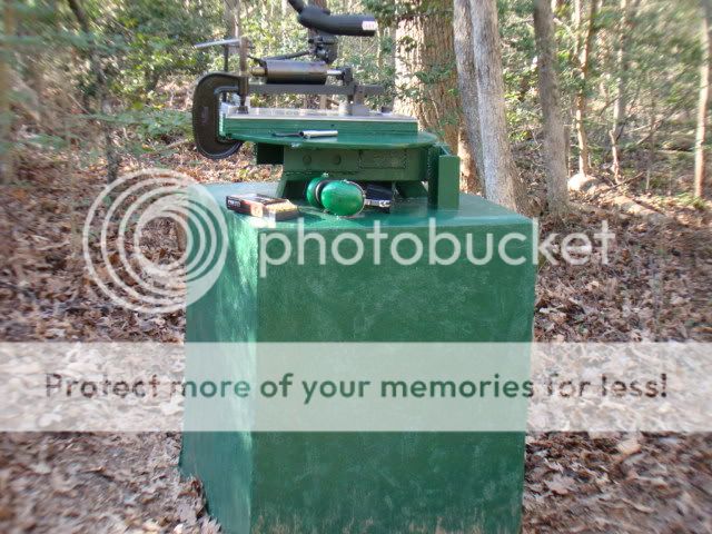

The stable base is VERY important. Even concrete and Steel has varying levels of stability. Somewhere on here is a link to the base that Jerry Keefer Uses. I think it is over 1.5 yards of concrete and some really heavy steel.
The next thing is to avoid touching the gun as much as possible. You will see videos where people reset after the shot by pressing down on the barrel. DON'T DO IT!!. After the shot you should reset by pressing on the rest itself.
I did not know about the cleanings, but I do have a friend who recently replaced his 40+ year old rest because of the work that it needed. His Base at home was a 55 gallon drum filled with concrete and sand. He got good results from it in his testing, but his major testing was done at his club that that system was 2 I-Beams welded into a 90 degree angle and set in 3 feet of concrete with about a 30 inch diameter.
The base that I am using was built at my club by Keefer when he was testing back in the 90's. It produced some good results then and my results from clamping my unit (mounted as per instructions onto plywood to that stand were pretty good (sub 2" results at 50 yards with my loads, and my inexperienced use.
I can't find the post that Jerry did about the base on here right now, but I have a link to the photo of the base with the barrel tester mounted. It is massive. The one at the club is not as large or as stable. But it seems to work ok. I believe that Jerry built it too.
