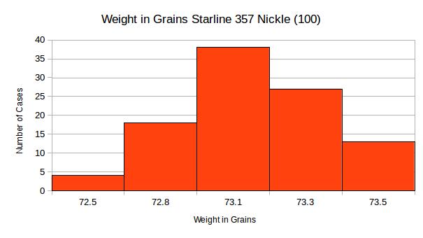

Post by Aprilian on 12/4/2016, 9:39 am
Thanks Chase.   I chose to do bands of roughly two thousands for starting.  Here is a photo of my results.
Instead of averaging, I chose to go with longest length as (no matter how small of a bump on the case mouth) that is what stops the case going further into the chamber.   I'm still thinking that might not be the best way as a long "bump" would not entail an even crimp from cartridge to cartridge.
Interestingly, the shortest case to longest case was 12 thousands.   I chose to throw .8850 and smaller into practice as I did with .8950 and larger,
Thanks for your help.
