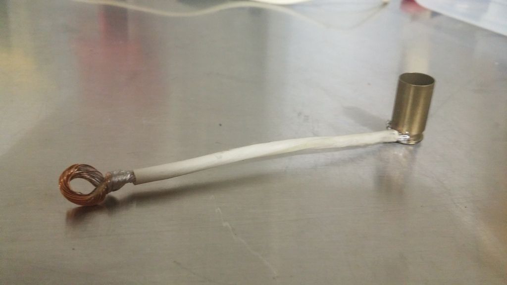

I use the entire Weigand set and it ends up being very consistent..I normally set the 45 at 24-25 Oz.
you can replace the little brass gauges with a New 45 case and then solder a hook onto the rim.. use that to pull it out with the trigger pull gauge

Good idea on the DIY option, I made one with some scrap wire and a piece of brass. Also another excuse to use my brand new Hakko digital soldering iron. Soldering to the brass was tough but it holds for such light weight.
As my extractor was set the trigger gauge read right at 32 ounces, I adjusted the bending gauge and now its at 24 ounces. Guess I'll find out at the match tomorrow if I fixed it. I could tell the case was easier to slide under the extractor after adjusting it.

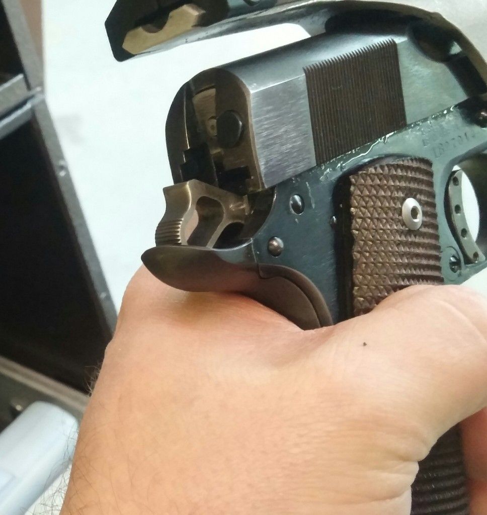

Ok, time for an update. With the new slightly lowered extractor tension I shot an indoor 1800 yesterday. On the first 6 magazines of slow fire I had 2 failures to go into battery, both were the last round of the magazine, that seems to be when it messes up for some reason. Both times it stops the slide about 1/4" from closing, the second failure I tried to get to close the slide on it again with no luck, you can see in the picture it put a little blemish on the back edge of the case so I assume the extractor was totally behind the case. I had to knock the round out of the chamber but once loaded into a magazine again it fired fine.
So somehow it seems that possibly magazine spring pressure is causing the last round not to seat properly. I've got several magazines and never had any magazine issues before the extractor change. My buddy had a plastic dummy round so I tried putting that in first and putting the 5 live rounds on top of that so that I would never have a live round be the last round of the magazine. This worked, I finished the centerfire round (12 more magazines) with no failures.
So does this narrow down the possibilities. I don't care to do work to the extractor but I'd like not just start hacking away at it aimlessly.

could be a combination of a extractor just a bit tight and magazine springs that have weakened. also the type of magazine follower can contribute to last round failures.. the last round may be moving forward in the magazine and when trying to feed it misses the extractor hook.
what mags are you using..

Not sure on the magazine brand as I inherited them when I bought the pistol. They all have rounded convex followers.
I may buy some new springs to give them some new life.
Also I took some suggestions and tweaked the extractor, I found some old Wilson Combat videos on how to tweak extractors, picked up some needle files and gave it a go.
