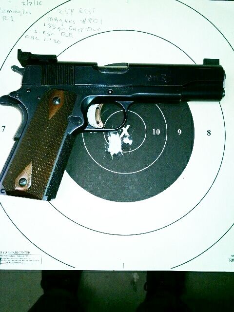

What sights on your R1?
Posts : 2821
Re: My Luck Is Terrible!!
Post by sawacs on Fri Jan 20, 2017 8:15 pm
Current sights on the R1 are the factory sights..
