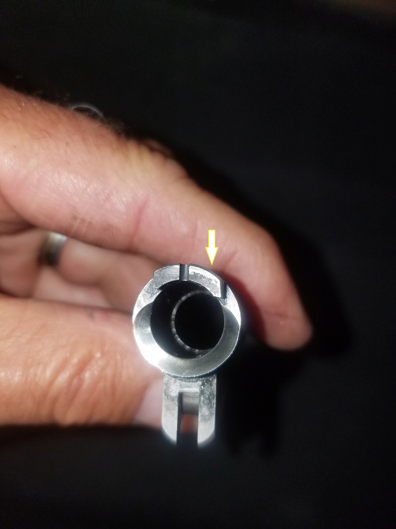

OK did some measuring and everything seems in order. The bushing is a bit off but there's some slop in the barrel bushing fit so I'm ruling that out.  But I did find something interesting and I think it could be part if not all of my problems as to why this RO is shooting left.
The right rear of the barrel hood is contacting very hard on the right side and peening  some while the left side rear of the barrel hood has .009" clearance.  I can see the peening on the hood and also it's marking heavily on the right side of the slide where the barrel hood hits it.  It may very well be that the barrel is getting pushed hard on the right rear and forcing the barrel to the left.  Like I had said there is some slop in the bushing with slide fit and barrel fit so I think this would be possible.  Also the left lower lug has a lot more contact with the slide stop pin than the right lower lug.  I believe this confirms my suspicions about the barrel hood pushing the barrel to the left.  If this is causing my problems it's an easy fix.
Something I'm sure Springfield wasn't worried about seeing as most shooting at closer ranges wouldn't notice.  This I can fix without sending back and it the future will re-barrel but for now I'll see what I can do without sending back.  Remember that this is with only 100 shots through this RO, I can't imagine how much peening would take place with a few thousand rounds fired.

Virgil Kane wrote:The right rear of the barrel hood is contacting very hard on the right side and peening  some while the left side rear of the barrel hood has .009" clearance.  I can see the peening on the hood and also it's marking heavily on the right side of the slide where the barrel hood hits it.  It may very well be that the barrel is getting pushed hard on the right rear and forcing the barrel to the left.  Like I had said there is some slop in the bushing with slide fit and barrel fit so I think this would be possible.  Also the left lower lug has a lot more contact with the slide stop pin than the right lower lug.  I believe this confirms my suspicions about the barrel hood pushing the barrel to the left.  If this is causing my problems it's an easy fix.
One side of the rear of my hood was contacting the breech face on my stock RO, with a  gap on the other side like you mention. I was shooting low to mid-90s on the short line but falling apart at 50. I planned to fit a Kart barrel anyway but didn't even notice this (1911 newbie) until fitting the new barrel. The breech face finish is gone where the one side of the hood was contacting. I did a lot of research and even found a thread where Jerry Keefer spoke about how the breech faces on guns may not even be perpendicular with the bore.
The gun never shot well at 50, and I always attributed it to my skill level. With a new to me borrowed gun in an EIC match my groups grouped and looked less like a shotgun pattern at 50. Even off a rest I was less than impressed and just thought the stock barrel was junk.
If you do file down the contacting portion of your hood, I wonder if the left side gap will close slightly or stay about the same at .009".
