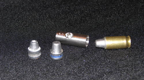

Hello folks,
I saw the link to this RRPMI DILLON SWC lead bullet SHOULDER-SEATING DIE, and purchased one. It arrived quickly and is of fine quality. It fit my Dillon seating die like the factory part. Tried it out today with my first batch of Magnus 185gr Swaged LSWC. Out of 100 loaded rounds, I lost 14 to the die cutting a slice off of the soft lead bullet nose. I use Dillon's new dies, so it is easy to remove the cotter-pin and dump out the die, clean the lead ring out and get back in business. I typically use Oregon Trail hard cast LSWC bullets, and don't have this issue with them. The swaged lead Magnus are quite a bit softer, and I hate to lose so many new bullets just to load 100 rounds, so any ideas on how to keep the swaged bullets from getting shaved would be most helpful. I have a decent bell on the case mouths, and it appears that if I slow down during the ram's seating stroke, the bullets don't get scraped or sliced, but I don't doubt that I am missing something.
One positive of trying the swaged Magnus is the consistent bullet weights. The Oregon Trails, being cast, are mostly 2 to 10 grains heavier or lighter, bullet-to-bullet. The 100 Magnus I weighed today were within 2 grains of each other, from 183 to 187 grains. I'll see how they group Monday. I appreciate any help on keeping my bullet seating failure rate down while using these bullets.
Thanks!
Amanda

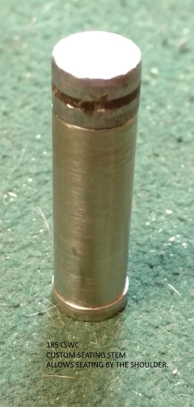

Post by james r chapman on Sat Jan 13, 2018 4:52 pm
Posting pictures of what I've done for seating .45 LSWC bullets by the shoulder.
I found the seating dies are coned and slightly smaller than the bullet shape. Either adjust the cone shape, or turn to a cylindrical Id and chamfer.
works for me.

Re: .45ACP Wadcutter seating with Swaged SWC's vs. Hard Cast
Post by JKR on Sun Jan 14, 2018 7:21 am
Ghillieman wrote:I have the same seater. Hold the bullet in line with the case as the press ram goes up. Let the body of the seating die sweep away your fingers from the bullet. Not sure exactly why this works but it does.
I use this technique as well. Works perfectly for me especially with flat base bullets. I've drilled out the Dillon seating insert so it only contacts the shoulder. Same concept as the aftermarket seater.
