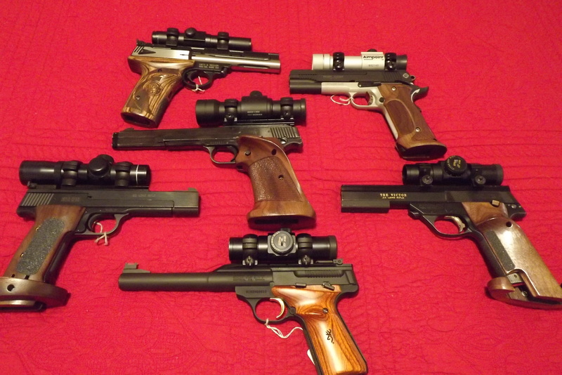

Post by firebrand on Wed Jul 26, 2017 2:42 pm
Apologies, Coming into this convo late, but I wonder what CO1 Mtn ended up with, & wanted to offer my recent experiences. Being new to Bullseye as well, I purchased the Mark IV Lite in June, installed entry level Bushnell RDot, was very excited as it was my very own 1st gun individually purchased, not given to me...Brought to our Bullseye Range & my Mentors said, "it's Cute".    Geezz, I thought it was bad a!*.   I was shooting very well at 25 yards, groups getting smaller and smaller, then had our gunsmith try to install Volquartsen Accurizing Kit. Trigger weighs @ 4.5 -5 lbs. Creep, roll, Break! Because of Polymer Base, Gunsmith was afraid he would break Polymer Base, couldn't get the last pin out. There is something to be said for straight up Steel. So, It is a good thing this happened, because literally 3 days later, I got the Recall Notice.
Luckily I was able to use my father's old 1976 Gold Cup .45 already w/ Nighthawk Conversion - but no way to attach the RDot (always buy the Full Package). Cannot shoot with out it. A little heavy for me, but with two hands (which rules permit for 3 years) I can manage.  My Mentor installed his Marvel Conversion, Swwweeet!
Now, for some reason I am off my game, and shooting horrid.
I have both on my dining room table With dry Fire plugs in them. Learning how to call shots (diff forum). The Ruger is literally stuck in between Safe and Unsafe - exactly what the Recall is. Called Ruger yesterday, they are sending my package today (Applied next day, & may have been a couple weeks out on the waiting list, which by the way, they sent out 900 packages yesterday).
SO: If you haven't purchased a pistol yet, and you can afford... invest in something that you can have forever and hand down like my family's Colt Gold Cup .45 and a conversion unit u can pop off. Don't skimp, all of this holds it's value. Ruger makes a gr8 product, & we own several, but if I could, I would buy something Classic.
