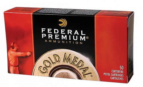

The Federal Rep told me yesterday that there is no performance or dimensional difference between ammo packaged in either the white or the gold boxes.  He said that it was determined by which the customer wanted. When questioned about COAL differences he told me that the COAL was determined by the SAAMI specifications denoting 1.190”-1.275”. However I noticed in the match .45 auto the COAL requirements were 1.140”-1.255”. He also told me that forums were a bad place to get info from. He also advised that this ammo had not been made for several years.

We are talking about the Federal 185 Gold Medal round, correct?
GM45B?

James Yes, and that was what I was told by the Fed Rep. He seemed sort of evasive when I tried to get him to divulge what internal info they used they used to determine best accuracy/precision.

On a side note, am I to understand they haven't produced Federal Gold Match 185s in a few years?!?!

You can buy 10+ boxes of Federal Gold Match 185 SWC from Bud's at $0.72 per round:
https://www.budsgunshop.com/catalog/product_info.php/cPath/656_2081_10000572/products_id/67126/Federal%20GM45B%20Gold%20Medal%20FMJ%20Semi-Wadcutter%20Match%2050RD%20185gr%2045%20Auto/

I definitely know it's available. I shot a box a month ago. I'm just curious if I understand Gary correctly that it hasn't been manufactured for several years....

BS, currently available

Poor representation of Federal products by that sales guy.

His statement was that it had not been made for several years and could become unavailable for some time.
