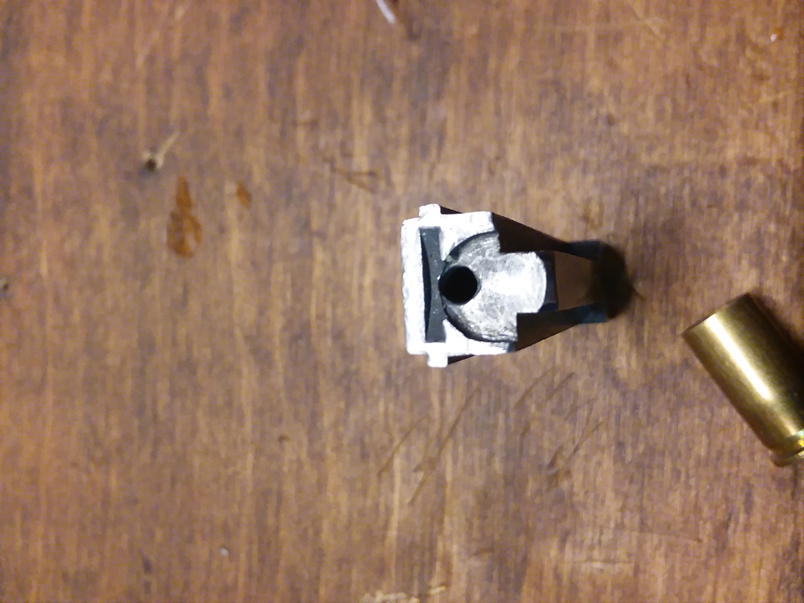

The bolt has a pretty simple design. They drill a larger hole in it till about the last 1/4" then drill a smaller hole in the face aligned with the rim of the 22. The way it is made the firing pin can come out anywhere you want in the recessed face. There is a lot of extra room in the bolt for changes. Bolt is also wide enough to have a little metal left around the recessed face. I think the extractor would work with no modification but could be dressed a little.
I was ready to post this then noticed your post. I had two thoughts about the mag. I have some old style that come apart and I could probably change their internal shape (Hammer) or change top of mag completely by welding new top. This is a 32 auto mag that would replace top of 41 mag.

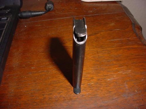

32 ACP
Post by ASchlem on 6/22/2018, 10:19 pm
Guys i have been working on such an animal for some time. If i can figure out how to reduce file sizes i will upload some a solid models. There is much more to it than a breach block and barrel. Every change brings 3 new challenges. The hammer must strike the firing pin correctly thus the center line of the barrel must follow, then the extractor, then the ejector and so on... I'm  a machinist with a small cnc/job shop at home and have spent countless hours reading and designing. The US Colt and m9111 shop manual have been my bible. My 9 to 5 works me 6 to 7 days a week, when i can catch up with my job shop work at home in the evenings  i will get back with it.  I already have several slides and a barrel ready to be lined. Magazines will be the biggest obstacle.

32 ACP
Post by ASchlem on 6/25/2018, 4:43 pm
can't seem to find a bersa 32apc magazine in stock.
