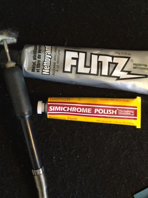

I prepare my Dillon powder measure before installing them - years ago I got advice from seasoned reloader Mr. Robert (Bob) DuBois witch I follow religiously.  I remove plastic hopper and polish drop area to mirror finish.  I'm sanding and polishing powder bars, inserts, and inside off powder measure powder bar housing - all surfaces that relate to moving powder.  I use 600-800 gr sand paper and then polishing compounds.  I replace Dillon powder adjuster bolts with my own to eliminate backlash, and Dillon fail safety bracket with my own to eliminate flexing in inconsistent powder bar return.  These gives me improved accuracy of powder drop to be in +/- 0.04 grains with most powders.
