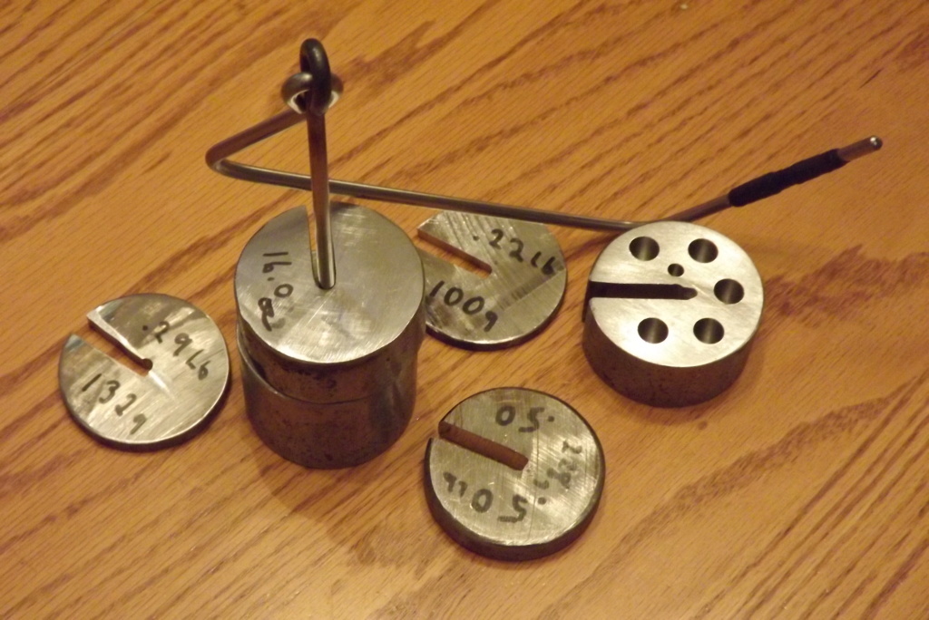

With a little creativity you also can make one that is just as accurate - use bullets as weight.

Some of us (me) are real cheapskates. I made one of these for my use. I even made an extra set then forgot who wanted it. Sucks getting old.mikemyers wrote:Which weight kit, with actual weights, do you guys buy so you can test this at home before you get to a match? Do they come with a range of weights?

Len, what type or brand of scale did you use to weigh your weights with? By the way, very nice job on those weights.

I weighed it with my wife's kitchen/diet scales. I tested their accuracy by weighing my calibration weights. Electronic scales SCALLO

That's not "cheapskate."LenV wrote:Some of us (me) are real cheapskates. I made one of these for my use. I even made an extra set then forgot who wanted it. Sucks getting old.mikemyers wrote:Which weight kit, with actual weights, do you guys buy so you can test this at home before you get to a match? Do they come with a range of weights?
This is cheapskate:
A Do-It-Yourself Trigger Weight
Re: Offical procedure for weighing triggers
Len, I looked them up, those are pretty accurate scales, and cheaper than I thought $12. I've got plenty of scrap round stock, band saw, drill press, and grinder to make weights. Ah, another project to work in with wifes HDs, I like mine better.LenV wrote:I weighed it with my wife's kitchen/diet scales. I tested their accuracy by weighing my calibration weights. Electronic scales SCALLO
