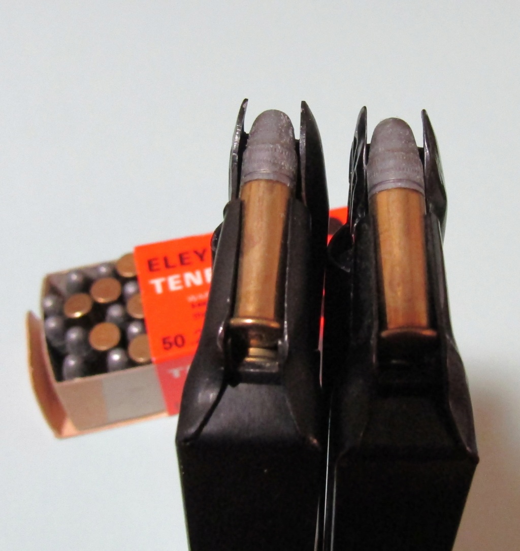

I have no measurements, but here are pictures
L>R Colt, Metalform fixed, Metalform before fix.  Colt and fixed work perfectly
Tuning Triple-K and/or Colt Steel .22 Conversion Magazines Marvel12
Tuning Triple-K and/or Colt Steel .22 Conversion Magazines Marvel13
L>R  Colt, MF fixed, MF in progress, MF unfixed

More pix of Colt mags
on left is pinned base Colt
Tuning Triple-K and/or Colt Steel .22 Conversion Magazines Img_0011
