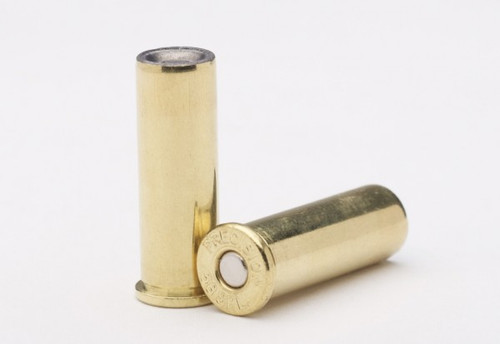

Does it look like this. Then yes.

Post by mikemyers Sat Sep 29, 2018 5:07 pm
Yep, looks just like that, but not as shiny!    :-)
If it didn't look like that, it wouldn't work in the M-52.
(If you took that photo, very nicely done!!!!!)

Post by james r chapman Sat Sep 29, 2018 5:35 pm
No, it's a precision Delta pic.
