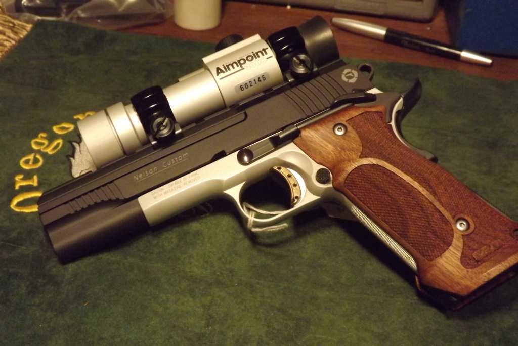

I started with two Nelson uppers I have (scoped & metallic sights), on a Kimber CDP frame with less than desirable results, no fault of the Nelsons. Never could lay a finger on what the issue with that frame was exactly, even after extensive troubleshooting, but finally just gave up and decided to go the dedicated frame route.
Bought a Rock Island 10mm tactical frame from SARCO, used mostly Ed Brown parts with a couple of Wilson Combat & Fusion Firearms parts mixed in. Put a KC Custom roll trigger kit in it and presto! Contrary to what you may read or hear I found the RI frame to be of high quality and finish, with no issues at all encountered in the build. Gun runs great...wish I could say the same for my marksmanship!

For a second conversion setup I removed the 45 top from a Range Officer and stuck an Advantage Arms unit on top. Only other thing is a KC hammer-sear set and main spring to 18# with normal caps and a Colt leaf spring. A Nelson works on it too. And I could put it back as a 45 anytime I want. My main conversion is a Nelson on a LesBaer by Roddy.
