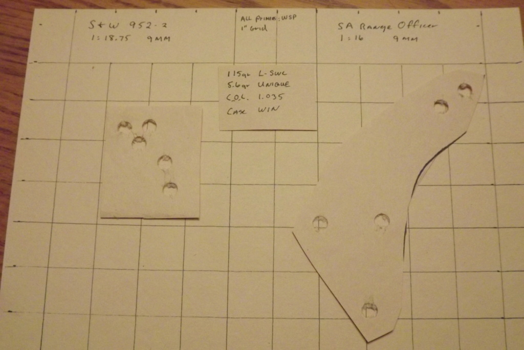

Post by LenV Fri Feb 01, 2019 4:26 pm
Finding the right load for your pistol. Priceless. Take a look at these two 9mm. The difference between these two pistols is very small. 1:16 and 1:18.75. The 952 is also a "match" pistol and the RO is stock (when testing was done) The only difference in this pair of targets is a different powder. I guess that is why we test. I should mention that I was doing this testing to find a soft recoil sustained fire load. I have a good LL load for both pistols. This testing was done at 25yds. I was looking for the alternative to the .45 also.
Benefits of different Center-fire gun (vs 45) Dscf0727
Benefits of different Center-fire gun (vs 45) Dscf0728

Post by Slartybartfast Mon Feb 04, 2019 8:18 am
LenV wrote:The difference between these two pistols is very small. 1:16 and 1:18.75.
In my mind, what would be really interesting would be the logic/physics/design choice between those differences. How much of the testing everyone does individually is really just confirming whether the designers knew what they were doing (but failing to communicate)?
