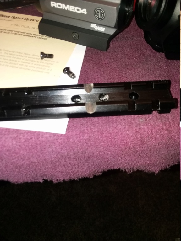

Post by LenV 3/21/2019, 3:15 pm
With a micro scope you only have to file one slot. The interesting thing is that only my Nikon scopes won't fit on the browning mount. I am not sure why the others wouldn't fit. I did have a small problem with the indent/relief for the bolt being in the wrong spot for the scope to tighten squarely.

Post by LenV 3/21/2019, 8:03 pm
Xman, You made me curious so I took a Buckmark out of the safe and played with it. I had zero problem mounting a Primary Arms/Holosun or a Sig Romeo4 on the sight rail it came with. Also the problem I mentioned about the ejection port area was just on the Rugers not the Browning. I have seen a problem when the mount is not quite opened up far enough getting a scope on but the two you mentioned should fit.
