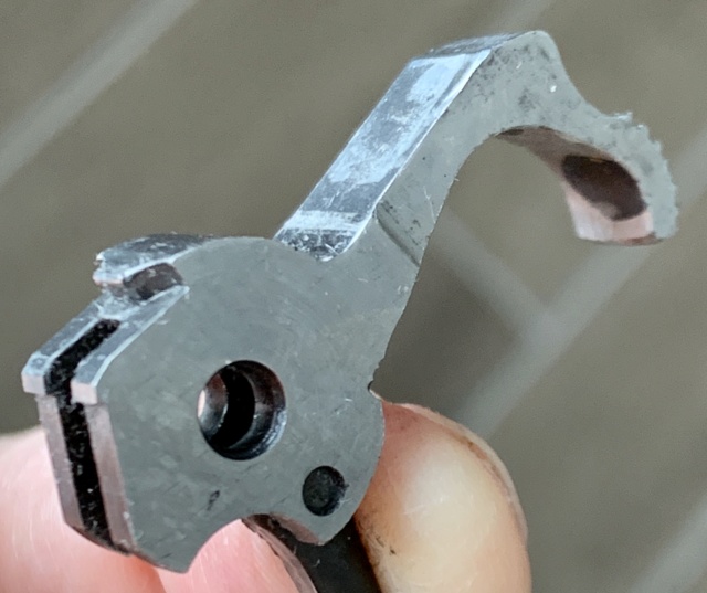

Regarding the small hole on the back of the Springfield the turned out to be for a mainspring safety, the Caspian part has the same hole. So does my Baer. Not sure why, yet. Unlike my other guns, the mainspring housing on the Caspian is curved, not flat. If I'm replacing parts, is this a "drop-in" part, or does it need to be fitted? I would prefer to make it the same as my other 1911's.
Hmm, I just found out I can reduce the size of images I'm posting here. Much better.
This is the part I removed from the Caspian:

Re: Nelson Conversion Kit
Thanks - my Springfield has the same hole. From a previous post, I thought it was for the "lock". In that case, my Springfield does not have the lock.
I had a discussion with a new friend of mine about the trigger, and how the slide has to push against the hammer to push it back. On my Caspian, if I lock the hammer back, then slowly move the Nelson slide to the rear, I can feel it bumping into the top of the hammer, and scraping across it going each way.
My friend told me that is perfectly normal, and all hammers act that way. I think he is right. This being the case, there is nothing to be gained by filing material from the trigger.
I have no idea as to what, if anything, I should do about the trigger. ....and if I replace it with a different trigger, I think this should be done by a gunsmith, who in effect will be doing a "trigger job".

Mike, if you haven't, read through the thread I posted on page 1. Might not be the hammer, might be the radius (or lack thereof) on the bottom of the slide rear.
Dcforman- Posts : 910
Age : 43
Dcforman wrote:Mike, if you haven't, read through the thread I posted on page 1. Might not be the hammer, might be the radius (or lack thereof) on the bottom of the slide rear.
Dcforman, I might not have understood what you meant. I'll go back and re-read. But my friend told me what I was worried about is perfectly normal, and the slide has to hit the hammer on its way back, and the hammer actually goes a little bit too far, so when you release the slide, the hammer is back where it belongs. I think I was wrong about this.
I was also wrong to think I needed the other magazine catch Nelson suggests. I watched the following video, and six minutes in, they show that if the magazine is hitting the extractor, so the slide won't close. I don't have that problem, the slide closes with no problem. My magazine does slightly push the extractor upwards, but as soon as I remove my hand from the bottom of the new magazine, everything seems to go back into place.
( https://www.youtube.com/watch?v=tIpPMFm5ubM ), starting around 6 minutes in.
I haven't yet disassembled the Nelson. I'm using it "out of the box". I guess I need to learn how to take the Nelson apart (without losing parts), and do a cleaning and lube.
My biggest problem with the Nelson right now is "failure to eject". I also have issues with the guns I have tried to mount the Nelson on. This will probably be my Caspian.

Dcforman wrote:Hey Mike. Classic spur hammers can sometimes cause issues with feeding with the Nelson's. If you rack the slide slowly, you'll see the slide drags on the hammer after it's fully cocked. Solution is to fire off 1000-1500 rounds to break it in, file down the hammer, or switch to a commander style hammer. I had some of the same issues with my Nelson at first. I filed down the top of the hammer, and played with the hammer spring a bit. Perfect now. .........
Dave, that's what is happening to me. As the slide moves to the rear, with the hammer already fully cocked, the bottom of the slide drags across it, going each way. That's why I was going to file the hammer. Now I'm confusabobbled, as maybe this is normal? I dunno.
As to the hammer spring, I think I need to work with one thing at a time. I was about to buy a 19# hammer spring, but that was for the Springfield. The Caspian already seems to have a light spring. With the amount of work that's needed for the Springfield, I've given up on using it with the Nelson. I'll put it back together with the 45 slide, and use it that way.
From now on, I think I'll stick to worrying about the Caspian. When/if I get it to work correctly, I'll start using it. Right now it's all apart, so I'm open to advice on what to do to update it.
- It's getting a new Caspian trigger, because the original was too short, and now I've found it was binding as it went in and out of the frame.
- It will get a new mag release to replace the customized one, if that turns out to be necessary.
- Depending on Jon's advice, it might get a new hammer.
- I'm not going to all the expense of a new beavertail and all the fitting - I'd rather put that money towards a new lower if I need to.
- It already has a light main spring, making it easy to cock the hammer.
That still leaves me with my biggest problem, rounds getting "stuck" in the chamber. I need to test it with my "dummy rounds", and then I need to learn how to take it apart and do a good clean and lube.
