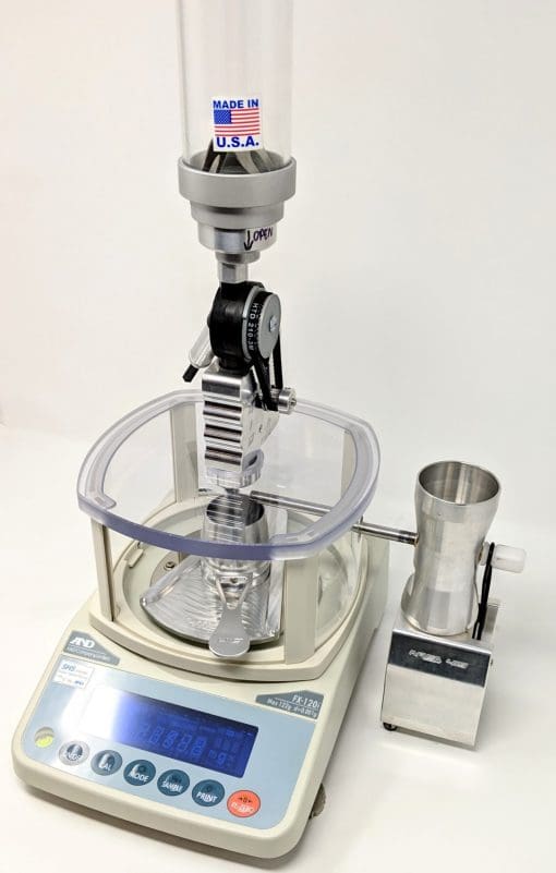

When starting a loading session or after any adjustment of the powder measure I...
NOTE 1: I know the having the press fully loaded may have an effect on the charge weight, however long as I am consistent (weight empty load full) I believe the effect is not significant enough to matter.
NOTE 2: Often the average charge weight is not exactly on a 0.1gr boundary. In this case sometimes I see the "full charge weight" added to the scale and sometimes it is off by 0.1gr, but it should always be in the same direction. e.g. if the avg is 3.85gr, I should see half the charges increase by 3.8gr and half the charges increase by 3.9gr, but I should never see 3.7, 3.8 and 3.9gr increase in the 10 charges.
Someday I'm going to get a real lab balance and pull samples during a loading session to see what is the real charge weight and part to part variability.
Older Pact digital scale, 0.1gr resolution. I can't guarantee the accuracy, but it agrees with a newer Pact (which is noisier and harder to read) and my old RCBS beam scale within 0.1gr. My test weight is a piece of bare copper wire weighing 3.8gr on each of the scales.JayhawkNavy02 wrote:
- I am curious how the charges were weighted by SteveT and how many (sample size). Sub 1/10 measurements are outside most powder measure scale capabilities.
- Run 10 charges through, returning them to the hopper
- Tap the case on the lip of the powder hopper to remove any stuck grains of powder
- Run the case through the powder measure station (all other stations empty See NOTE 1 below)
- Pour the case into the pan on the zeroed scale, read the value
- Repeat, pouring each case in the pan, mentally I add the charge weight to the current weight displayed before pouring, so I can see if there is significant variation
- If I see more more than 0.1gr variation in one direction or if I see both positive and negative 0.1gr variation, I stop and investigate (NOTE 2)
- At the end of 10 charges I tap the case into the pan (to get all the last grains) and take the average charge weight

Steve,
I for better or worse, fell into the trap of a labatory scale. Knowing the exact weight led me down a path with no return and didn't correlate to increased scores....
I do not tap or in any way contact my press/reservoir as to avoid disturbing the powder. If I disturb the press, I will discard the throws and start over. After using a lab scale, it causes disruption in the next 1-2 throws. I also let my scale "warm up" for about 30 - 45 minutes. I plan to upgrade to a better scale, but after my son goes to college as I want it to be protected.

Thank you, Steve.
Here is the new model of balance I use - https://myweigh.com/product/gempro-300/
It has even better +/- accuracy then older model - 0.001g or 0.015gr. Mine has 0.02gr. And it is not overly expensive - http://store.xtremegunshootingcenter.com/index.php?main_page=product_info&products_id=956#.XXWy4E1YZN4
I can attest that warranty is also great. But that is for another time.
I often measure as I load - prime case, remove case, put it on scale and zero scale out, put case back, drop charge, advance press, remove case and put on scale again - it will show weight of charge. It is rather quite easy with electronic balance like one above.

The problem with inexpensive digital scales is that they're almost without exception strain gauge type. Strain gauge scales are you typically find in bathroom, kitchen and general purpose digital scales. That doesn't mean they're bad or unusable, but there are constraints/limitations to be aware of. You can help mitigate drift and fluctuation with a power conditioner/Uninterruptible Power Supply (UPS). This will assist with minor power surges, brown outs, spikes, harmonics, radio frequency noise, etc. On the cheap you can attach ferrite chokes for a few dollars around the power cord to eliminate some RF noise and harmonics that affect the load cell, or use fresh batteries and isolate the scale from the home and avoid the ferrite chokes completely.
One common way to get great results is with a force motor or electromagnetic force restoration weighing balance also known as a magnetic force restoration weighing balance. They still require warm up, regardless of the claims otherwise. Sartorius makes great scales IMO and allow you to trickle a charge very efficiently.
https://balance.balances.com/scales/569
I'm working on a DC motor to drive an RCBS powder trickler with variable speeds via a remote motor controller to create a "poor man's prometheus" for long range rifle after seeing the below. Not that hard with with some hobby grade electronics and junk I have laying around. I haven't had the time to get it to the point I can get it to auto trickle yet; because, that requires feedback, and I haven't been home.

Hm.... another area where we are in agreement. I'm etching to get 64-1S model. But then, I'm a lousy shooter. What I have should provide for improvement.
For your "prometeus" project - permanent magnet step motor might be worth checking.
AP
AP

PhotoEscape wrote:Hm.... another area where we are in agreement. I'm etching to get 64-1S model. But then, I'm a lousy shooter. What I have should provide for improvement.
For your "prometeus" project - permanent magnet step motor might be worth checking.Not
AP
Doesn't mean you can't have nice toys
I have a 4-Pole brushless 12 slot motor with ABEC5 bearings and high purity windings with neodymium sintered magnets from a discarded past project that I can control from my computer or cell phone (blue tooth) via an Electronic Speed Control (ESC). I can control the powder rate/volume to the scale, but only manually using the motor RPMs to alter the drive speed of the belt. I haven't figured out how to get the scale to "communicate" to my ESC to have it stop driving rotation of the belt without breaking in to it and voiding the warranty. There's no output communication from the OEM scale to transfer data unfortunately. Fundamentally, the motor exceeds requirements, but free since it's unused a collecting dust. Not a huge deal to lack the feedback loop, as it only automates the process for long line rifle ammunition which I use once a year, if that. The RCBS ChargeMaster 1500, s also a strain gauge type, but has all that functionality, just not as precise. You could easily verify throws on a better scale and redo those out of tolerance. With the limited amount of 600 - 1000 yard ammunition I make either work. All of this is unnecessary for pistol, short or long line.
