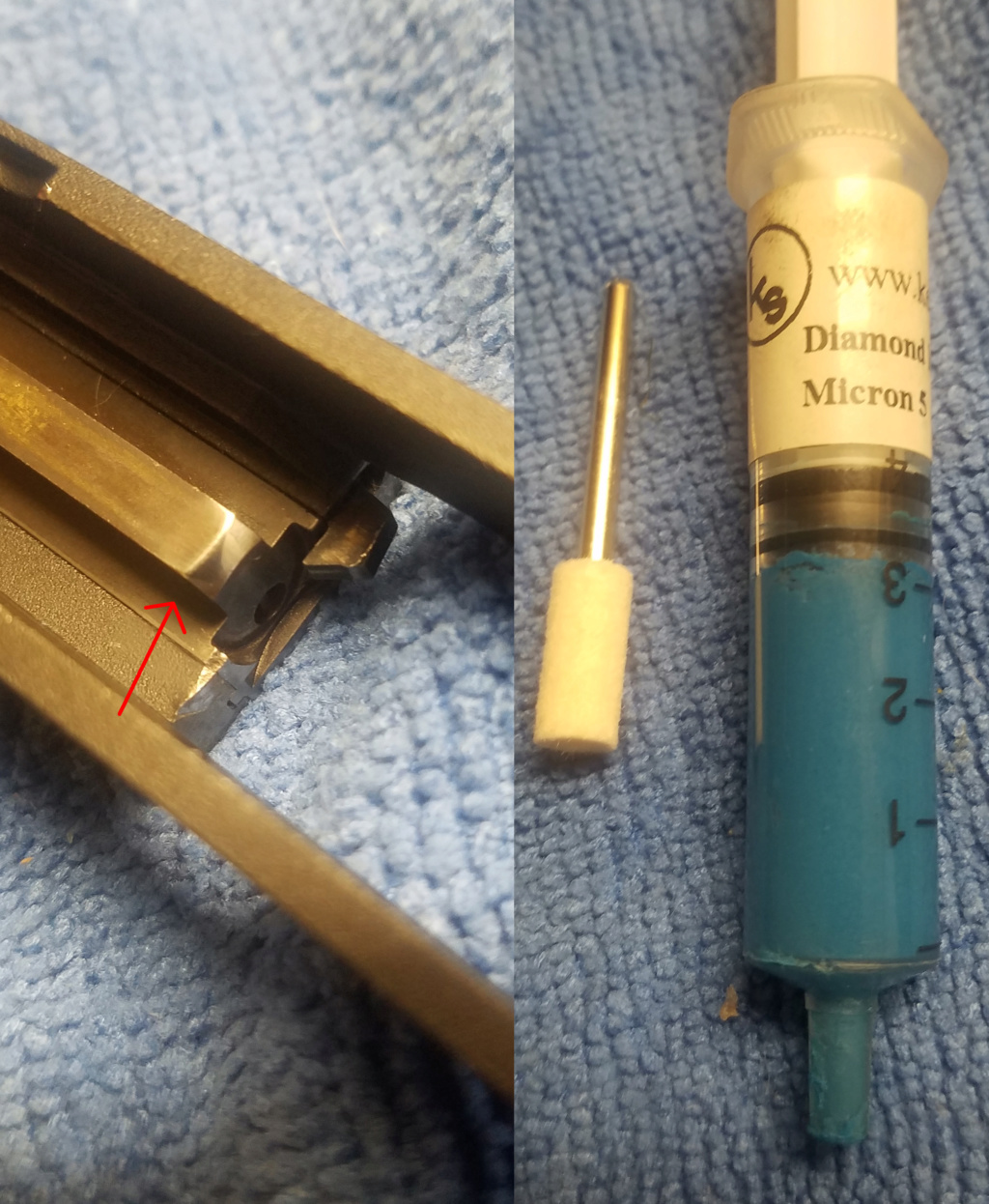

Cci has a waxy lube.. try european rounds that use an oily style lube. I found my older 41 loved RWS ammo. Mainly Norma tac. Give it a try. Yes the volquartsen extrator us a better design mainly because it a bit shorter. All smith extractors are too long, a problem that was somewhat solved by bending it shorter. The volquartsen can be very good if tuned properly by a smith to only touch the case rim..22 extractors mainly guide the round to the ejector after they are blown out of the chamber.
Plunk test to insure the chamber is not rough or clogged with carbon. I always clean the chamber with a .25 cal. brush...
Try a different style ammo
Use the volquartsen extractor
Follow a logical track to resolve the problem.
The 41 can be very reliable if properly setup

I had some similar troubles with my S&W Model 41.
Upon examination with a borescope, my chamber was a little rough and had an area of pitting. A few seconds of polishing with this smoothed it out nicely and the problem was basically solved.
Brush Research 06380 Rifle Chamber Flex-Hone, Silicon Carbide, 400 Grit, For 0.17 Colt Cartridge/0.22 Magnum (Pack of 1)
https://www.amazon.com/gp/product/B00DB8D1RW/ref=ppx_yo_dt_b_asin_title_o00_s00
I also swapped out the extractor for the Volquartsen part referenced earlier in this thread.
I still apply a small drop of very light oil (I use the thinnest Rem Oil) on the brass of the first round in the magazine.
My gun was also failing to feed, doing this to rounds in the magazine:
Which required smoothing and polishing a part of the gun which was very sharp from the factory:
I only shoot CCI SV out of it. I'm a little annoyed that the above was necessary, but it's been flawless since then.
