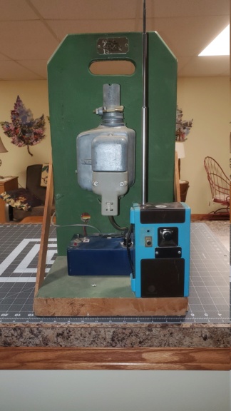

Post by 8eightring 4/30/2020, 3:59 pm
Here is one of the Frank Thomas turning targets. It has the wireless remote. Plug a momentary contact switch into the remote and start the timing sequence. There is a three second delay, and three, 10 , and 20 second face times.
It is a 12 VDC unit. It came with a small gel cell battery that is long gone. I just have a small 12 VDC lawn tractor battery for it now.
Frank wrote on the side of the remote with a Sharpie 27.195 MGZ
I have had to open the timer box and blow out the dust. There are potentiometers inside to adjust the time settings. Also there are replaceable relays in case you are having trouble with your unit. I did have to take the cover off one of the relays and blow the dust out so it would make good contact.
After all these years the target still works great. I am 71 so it will probably outlast me.
 Frank Thomas Turning Target system - Page 2 20200411
 Frank Thomas Turning Target system - Page 2 20200410
