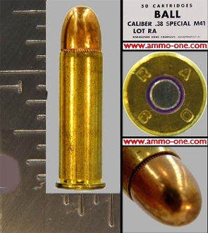

Post by Wobbley Mon Mar 09, 2020 10:38 am
Tim:H11 wrote:How do you know what’s too much or not enough crimp by the way?
Load and crimp so the round looks like this.38 Special with 158 grain SWC Loads for DR 44295410
The round pictured has a different bullet but the crimp area is perfect.
The test is to load a “sixth round in your revolver and then shoot 10 full power loads in the other five cylinders.  If the bullet moves at all you need more crimp.
