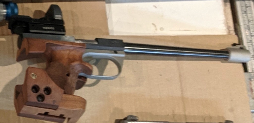

With the Governor's stay at home order allowing me to catch up on all my reloading but no matches to expend the ammo up, I decided to fire up the mill and vandalize my Toz and mount a 3 Moa Scorpion Red Dot. I have the good fortune to be able to get to our clubs range and test my experiment if it does not rain tomorrow. I've always wondered what it could do if my old eyes and iron sights got taken out of the equation. I'm now a fugitive from the ISSF match police for my act of vandalism!

how did you do it
My eyes are very bad and I use red dots or scopes. I've just purchased a TOZ and have been thinking about this. the 2 holes on the back look perfect for mating a scope base to. Any suggestions?

Re: My Toz 35M got vandalized!
Rich,
That's exactly how I did it, I used two 1/4 inch T-10 6-48 oval head screws and tapped the scope base stock same as the Toz rear sight spacing. I have a mill so I milled a slot in the base .065 deep mate with the top of the tang for positive alignment but that probably is not necessary. I have the hole spacing measured if you are interested, that could make it easier if you are going to layout one using a drill press and punches. I used blank weaver base stock I got as drops from EGW but you can find lots of flat based Picatinny and Weaver base stock at Brownells and other outlets. The Weaver/Picatinny base that comes with the Venom is just the right size to mate up with a base made as long as the tang but I bet the other reflex sights may work too, I had one on My Sig P210-A and the Weaver/Picatinny base was not used on the Sig so that's how I got the idea.

if you could send the spacing that would help. Your data is welcomed.

It happens that I went through a phase of fitting Vortex Venom red dots to most of my handguns a few years ago. I bought lots of the mounts which replace the standard dovetail fit rear sight on 1911's, etc. When I got into Bullseye I discovered that the Venom's didn't suit my eyes and so I switched to Ultradot's and sold the VV's. But I still have several of the mounts.
Rather than drilling and mounting a length of weaver/picatinney rail and then using the intermediate mount that comes with the VV, another option is to create a flat plate which is attached with screws on to the TOZ receiver and, in turn, the VV screws on to the plate. Need to drill/tap the plate to receive the screws through the VV.
Here is one that I made by cutting down one of the standard intermediate VV mounts (for a 22 like the TOZ I would say that the locating pins are probably not necessary):-
Yes you can always drill the plate too, I wanted to leave my weaver/picatinny plate alone, there is a very good chance I will be swapping this unit to my other plinking handguns that have weaver or Picatinny bases, it's easy to get the dot sighted close with my laser bore sighted in the shop and dial in the final settings in only 3-5 shots at the range, this if form my second tier non competition guns.
