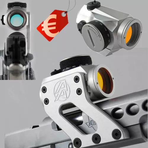

Post by dronning Fri 12 Jun - 20:53
I was going to mention the KC integral cut but you beat me to it.  I have one and am thinking about converting 2 more guns to the integral cut.  There are a couple of frame mounts that put the H1 right on top of the slide - almost touching.  The only issue is it reverses your windage and elevation adjustments because it is mounted turned 90 degrees.
The Double Alpha being one of them.
