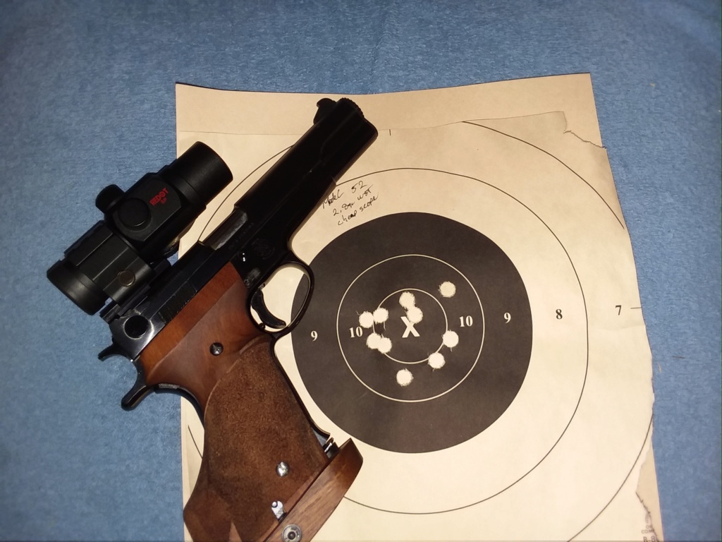

Re: The S&W Model 52
Well, out of curiosity I checked mine too. They are all 52-2s. Oldest one from 1973 has no markings on the bottom at the magwell area at all. This one has s/n: starting with A1.
Latest one has s/n THB5xxx. It was manufactured in 1990, and has letter L. And then there is one in between, also with s/n starting with A, A4. This one has 0 or letter O, - not sure what exactly.
John, I'm not in position to dispute what you were told. However when season is over, and weather permitting I'll ransom rest all three. More so, the ones from 1973 and 1990 have Clark's 1:10 barrels fitted, and as well I have both OEM barrels. Fitting was done by Clark's gunsmiths, and condition was "no change to the bushings". So I should be able to test OEM and Clark's side by side. I have some good old Remington match ammo, and as well my own reloads, that were tested at 50Y, and proved to be "very promising". That probably will be in late September.
