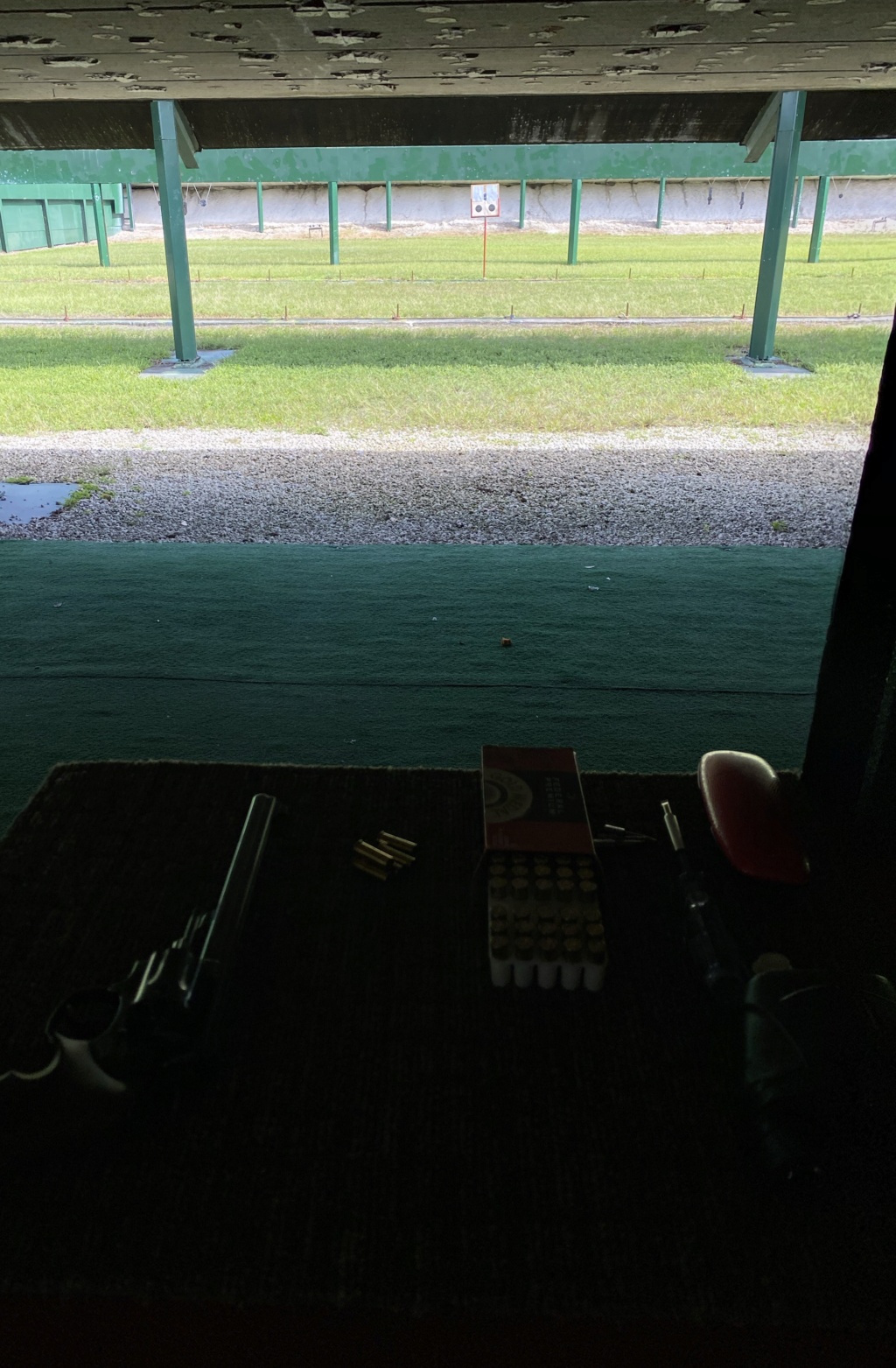

Re: What do people use nowadays to "blacken" the rear surface of their steel sights?
I noticed that, but it doesn't apply to where I shoot. We shoot from inside a "shed", and everything, including the sights, is quite dark. There is no glare. I do notice that the "black" of my sight is the same darkness as the "black" of the target.
(I assumed what CR wrote was for people standing outside, in an open area, which doesn't apply to where we shoot at my club. If there would be no benefit from making my sights "blacker", then I guess there's no need for me to buy one of these......)
I deliberately over-exposed this image, so at least some detail on my shooting bench would show up. The bull on the target normally looks blacker than what is shown here.
The saying 40 years ago was "You shoot toward the light" if the sights are not blackened (Carbide black is a non-reflective flat black.) to get the glare off. Sun (Point light source) from the right makes the right side of the front sight appear to disappear and you then center what appears to be the remaining sight. Resulting in you aiming right. In competition I always blackened both front and back. Carbide last for that days shooting only.
If what Cecil said above doesn't apply to you on your home range, don't waste your money (or do)? The advice is solid...whether you choose to take it or apply it is entirely up to you....mikemyers wrote:I noticed that, but it doesn't apply to where I shoot. We shoot from inside a "shed", and everything, including the sights, is quite dark. There is no glare. I do notice that the "black" of my sight is the same darkness as the "black" of the target.
Sorry, if I wrote things poorly, my fault.
The reason I got involved in all this was because I couldn't get the sights on my model 14-4 revolver adjusted. I wanted to shoot it sub-6-o'clock hold, and shooting it center-hold wasn't working. I eventually did fix the revolver, but a few days ago I tried to shoot my Baer Premiere II, both sub-6 and center. The sights and the bull all merged into a single dark colored blog. Then I posted this thread, giving the link, and asking how to make my sights more "black".
From what people here have said, especially CR, is apparently the real reason for using the carbon, but I thought it was also a "fix" for what I was trying to do. I like trying things, to see for myself, even when I'm given an answer. I'll likely buy this device anyway - it's not all that expensive. I guess it's unlikely to do much to improve steel sights over a black target with a center hold.
I'll certainly remember this discussion, should I ever find myself shooting somewhere without a "roof" over my head. Thanks for all the feedback. This thread is more informative than the article in "SSUSA".
