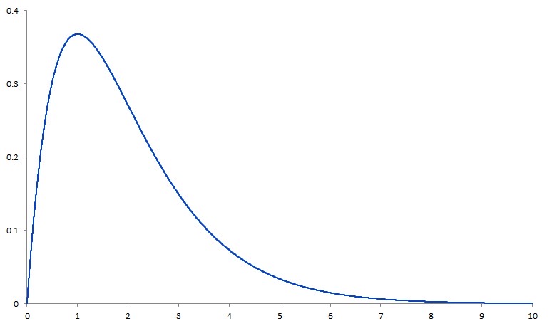

tovaert wrote:I've done a bit of RR testing. It's definitely an interesting method. There have been times when I've loaded the same ammo (from the same lot), tested it, and produced a 1.5" group at 50 yards with a pistol (Sig P210A and RR 1911A1). Then, months later, I use the same lot of ammo and it opens up to 2.5". The RR itself and its pistol mounting method is not even close to being "robust" from a design standpoint. But of course you compare that to hand-held off of sandbags. But I would say that when the stars line up, and the human factor is eliminated, I have a 1.5" pistol at 50 yards if I can produce such a group, even once. If the pistol/ammo was not capable, it would not happen by accident.
There will be normal variation in size from one group to another even using the same ammo. It's unrealistic to expect every group we fire with the same ammo to be the same size (within a limited standard error).
Members might find the article below of interest. It explains why group sizes differ, and why small groups do happen by chance.
https://www.ssusa.org/articles/2019/9/25/accuracy-testing-shortcomings-of-the-five-shot-group/

I think the following is worth watching for those who like to test.
In the Youtube videos below this gentleman explains things very well; his explanation about "nodes" applies to both rifle & pistol.
Part 2 is better.
Part 1. https://www.youtube.com/watch?v=oRXlCG9YZbQ
Part 2. https://www.youtube.com/watch?v=9FKq8Jj8YEI
