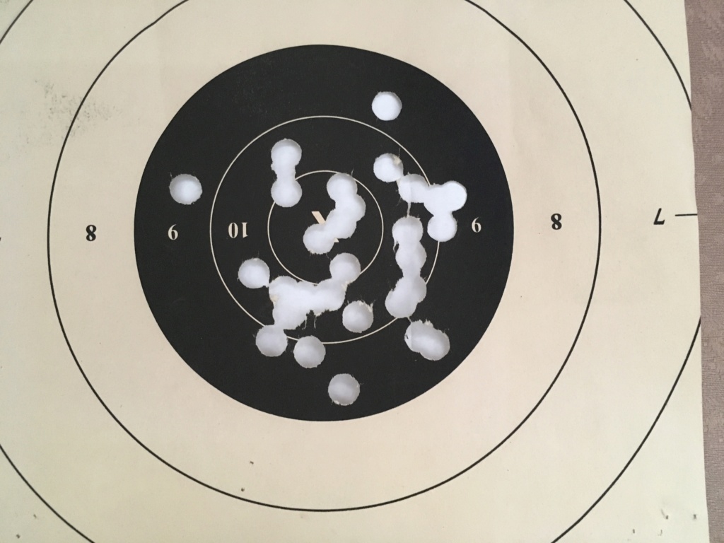

Gary Collette- Posts : 124
Join date : 2020-01-21
Re: Clark 38 Wad Gun Experts
I own and shoot a 52-2 and can say that the 52 isn’t as accurate as my 45. Close, but not quite. Here are two targets one from the 52 and the other shot with the 45. The 52 was shot with Magtech factory and the 45 was with my reloads. Getting a GOOD reload for the 38 is a process. I’m close, but I’m not there. But the 45 I have IS. more accurate.
