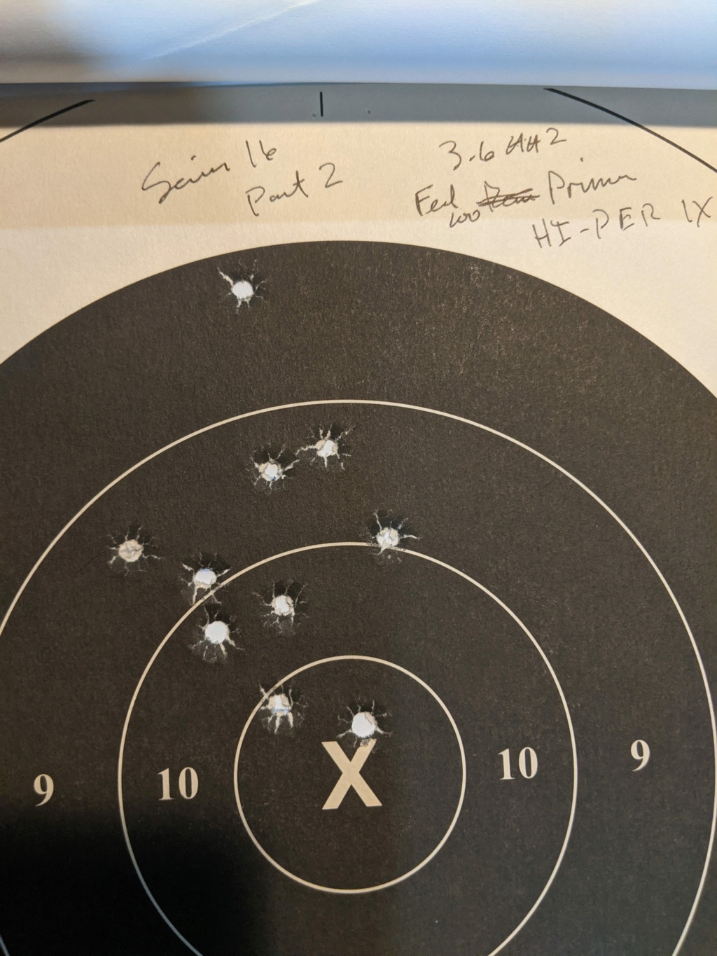

Those of you here that know me and that have seen my previous posts know I like toying around with revolvers.
I love the Distinguished Revolver matches, and I’ve really enjoyed working up a load for my gun. I’ve noticed that there are a lot of theories and beliefs or stereotypes for DR equipment and ammunition. So I’m going to throw this info out there just for people to read and draw their own conclusions. These are 10 shots fired from a sand bag and the top of my pistol box, through a chronograph at a target placed at 50 yards. Enjoy!
Gun: S&W Model 14-3
Ammunition:
Hand loads,
2.8 grains of Hodgdon Titegroup,
Federal Small Pistol Primers,
Federal Wadcutter Match Brass Once Fired,
158 grain Cast Lead Round Nose Bullet pushed through a Lee .357” sizing die after being tumble lubed in Lee Liquid Allox,
Lead used was wheel weights,
Mold used was a Lee 6-Cavity Aluminum Mold (tumble lube design of bullet)
Gun: S&W Model 14-3
Ammunition:
Hand loads,
