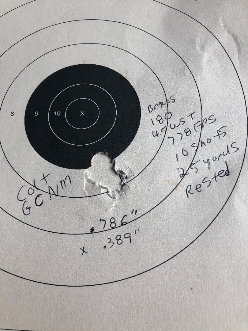

Post by Wobbley Sat Feb 13, 2021 5:10 pm
Two targets shot with same gun.  One with optic fired with Brazos Coated 200 grain bullets, fired offhand.  The other shot with lubricated lead bullets from a rest.  I can’t tell the difference.  Coated are easier to load, feed thrue bulletin feeders, and cleaner.
Lead vs. jacketed bullets - Page 2 0beb9010
Lead vs. jacketed bullets - Page 2 65274210
Posts : 3891

Post by David R Sun Feb 14, 2021 9:10 am
I went with coated because lead poison.
They don't smoke near as much at the indoor range too.
Today, I can't find any 9 mm HAP, so I am shooting lead from my new P210.   Jacketed will make smaller groups, but I can't buy any so Lead it is.   I am getting 2" @ 25 yards with Brazos 150 SWC.
I can get under an inch @ 25 yards with my PM-9 using lead or jacketed.  Two years ago, I shot  115 HAP all season.
With my 45 I can't see the difference.  I bought 500 of the 185 Zero JHP.     They do not shoot smaller groups than Brazos coated.   I loaded the rest hot and use them for practice in my self defense guns.
Lead vs. jacketed bullets - Page 2 18011se guns.
I shot the target to the right with Brazos Coated and this one.
Guess what I am loading for this year?    Smile
