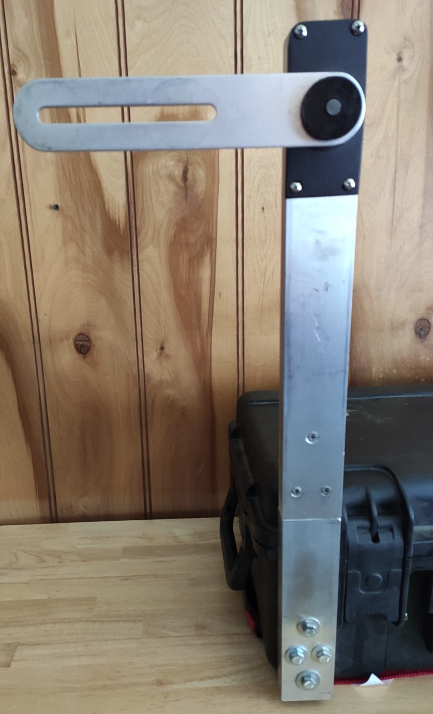

There were threads on the subject of best cases/boxes for travel, innovative Bullseye Boxes and, most recently, on the types of foam for Pelican type cases. I did not have photos with me at the time of those threads - so here is my latest innovation. I already had (pre-Bullseye) a Case Club 6 Pistol & 20 Magazine Case (not a Pelican, but same style), but the closed cell foam insert that came with that case was no go good for Bullseye guns. I also had a HYSKORE #30277 6-Gun Modular Pistol Rack which I had intended to use in a gun safe. The Hyskore can easily be dis-assembled and custom leaves of Neoprene sheet can be inserted. Some black closed cell foam and some thin plywood completed the internal fit-out. The scope mount is Aluminum section, reinforced with some strong hardwood. Since I understand that the airlines require ammo to be in a separate box to guns, I will put the removeable "leg" and the scope in another bag with ammo bag and anything else I need. I am now looking for a Duffel Bag or similar that I can put this case inside so that it is not so obvious to everyone that there is a bag full of guns on the carousel!
It is tight (let's just say "snug"), but all 6 guns do fit together with a box of tools and parts and a box of cleaning stuff. There is also room for a small bag of magazines that fits under the barrel muzzles on the right side.
I am one slot short if I need to carry a DR as well as a Reeves Revolver (or an additional 1911), but they could always go in a small gun case inside the Duffel Bag and be left locked in the car trunk.
And yes, all of the muzzles are pointing downrange when the box is on the bench.
And, yes, it is bloody heavy!

You are almost right. The middle Pardini is currently fitted with flat (ISSF) palm shelf and 5" barrel to match NRA International Standard Pistol rules. For EIC I would use the upswept palm shelf and 6" barrel. The middle gun on the right side is not a 1911 - it is the SIG P210-A 9mm that I prefer to use for EIC Service Pistol. And the "obligatory" revolver is special - a S&W K16-4 32 Magnum - Roddy has just gone through it and got the trigger up to NRA weight and sorted out some other issues - it is great now and perfect for Harry Reeves matches.
The reason for the photo of the guns was not to brag about my set of competition guns (although I am certainly proud of them), but rather to illustrate that with some careful arrangement of Neoprene padding it is possible to comfortably and (hopefully) safely pack 6 competition guns in that one case and still have plenty of room for tools,etc.
