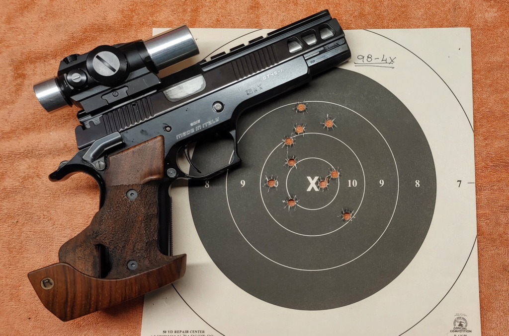

I have been working on accurate and reliable loads for my Pardini GT45 and I think that I have finally developed a great long line load:
Bullet: Zero 185 Gr JHP (Zero ID - R187)
Brass: New or Once-Fired Starline
Primer: CCI Large Pistol Primer (but I don't think that the primer brand makes a difference)
Powder: Vihtavuori N310 4.4 Gr
OAL: 1.205"
Crimp: 0.469"
Results:
I shot a practice match today and here is one of my 50 yard targets (98-4X):
JHP Load for Pardini GT45 - I hit the sweet spot! Long_l10
