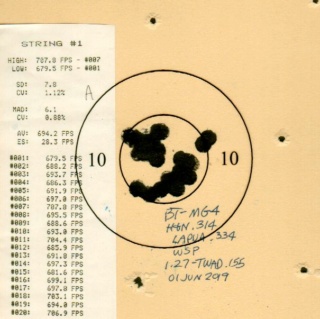

I tested a factory MG4 barrel a while back. If memory serves me well, the groove diameter was 0.314" maybe 0.315".
Here are my test targets fired at 50 yards using bumped Speer HBWC and out of the box Speer Plinker HBWC.
There are two targets using the unobtainable H&N 0.314" I had left over.
The bullet diameter needs to be equal to or slightly larger than the groove diameter.

Thanks for that Dave. What I'm expecting from the gun is something along the lines of target 2 or 3 (this is 25 yards I'm talking about). What I'm getting is more like 4 & 5. I haven't tried 50 yards yet.
Looks like I need to learn how to slug a barrel and find out what actual diameter is required. Ah well - it would be boring if I had all the answers.
