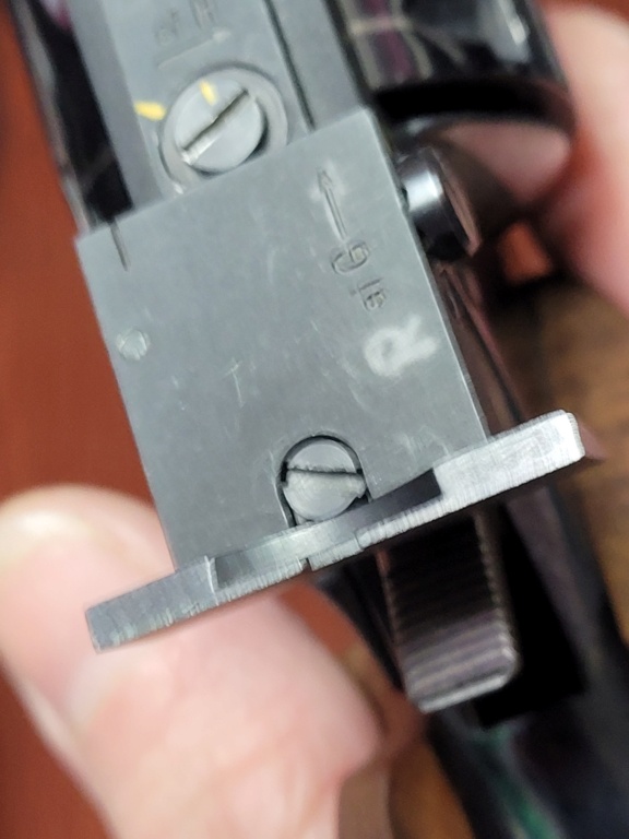

Post by RoyDean 10/8/2022, 5:34 pm
I have just bought one of these fine revolvers and on carefully looking at the extended rear sight I discover that the sight blade unit is removeable. The one supplied with the gun has a notch 3.1mm wide. It is stamped #1. I prefer a wider notch. I am guessing that Manurhin offer blades with different widths (the rear sight is, I believe, common to both the 32 and 38 Match models). In the past when asking questions of the current USA Importer (Beretta), I have not got much of a response.
Anyone know where I might find Manurhin Rear Sight Blades?
I have sent an enquiry to Chapuis Armes and also to a large dealer in The Netherlands.
RoyDean

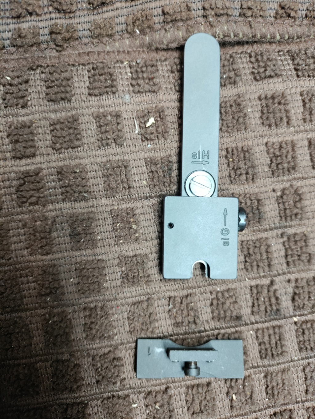

Now that I know the sight blade unit is removeable and (somehow) replaceable I am probably going to widen the notch with a file and then get a replacement bought/made in due course.Manurhin MR38 Match rear sight blades Img_2077
Manurhin MR38 Match rear sight blades Img_2076
Manurhin MR38 Match rear sight blades Img_2075Manurhin MR38 Match rear sight blades Img_2078

Post by Steve B 10/10/2022, 3:24 pm
Tripscape wrote:Steve,
Is it Mulhouse or Chapuis, date estimate, and if you can.measure blade nothes corresponding to blade numbers? You would do us a great help! Thanks.
Yev
The gun is no more than 3 years old, it was imported the year I bought it.  It was built under Chapuis.
My MR38 has the #4 rear sight installed at the factory, it's width is .125".  The #3 rear sight measured .137" and the #2 measured .133".  Kinda interesting that the sight blade widths don't increase linearly with the sight number...
Thank you for bringing up this topic, I may try the next wider blade now.

Post by RoyDean 10/14/2022, 9:57 am
The ever helpful FC60 has sent me further info about the sight blades.
In previous times the factory sent out a set of 3 blades blades with the MR revolvers.
Usually the gun comes fitted with blade #1 which has a 3mm wide notch. #2 is 3.25 mm and #3 is 3.50 mm.
Good to know. Thanks Dave.
