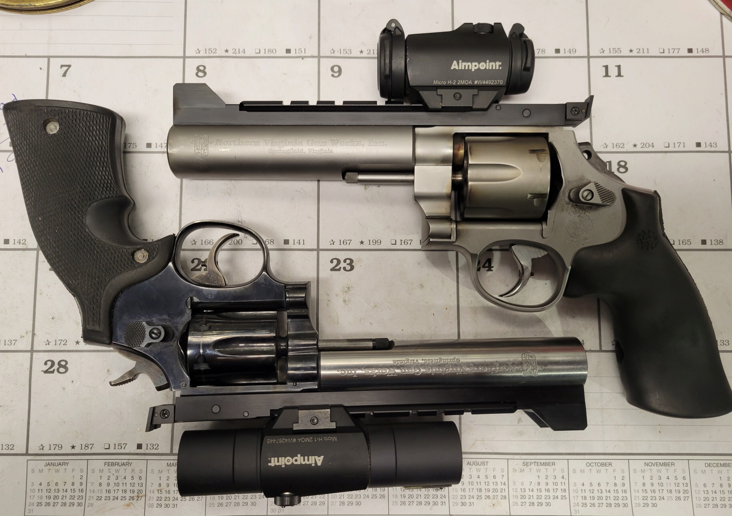

Re: PPC revolver
I use these three for bullseye. A .22 Model 17 with Shilen barrel. .38 Model 10 with Krieger barrel .45 Model 625 with Douglas barrel. (Oops, 38 not in picture.) It is set up exactly like other two. All Garrettized by NVGW in Springfield VA. I shoot double action across the course. Top .45 It has RevUpAction hammer. Yes, both heavy.
Last edited by Allgoodhits on Wed Oct 12, 2022 10:51 am; edited 1 time in total (Reason for editing : additional info)
