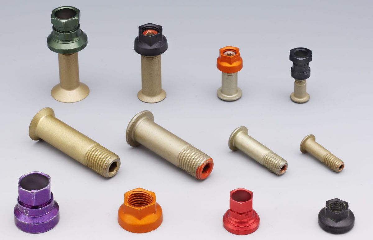

I am tempted to find some HI-LOK collar removal tools. In the 1980/90s we had some that were like an outside reamer to wipe out the aluminum collars.
