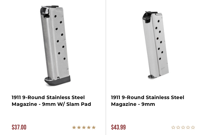

Post by mikemyers 1/25/2023, 2:12 pm
I'm convinced - that last response happened to me, and with nothing to grab onto, I thought I was stuck.  Lots of good reasons.  The magazines that came stock with my new (to me) Springfield Range Officer 9mm Target don't have bumpers - seems like a nice addition.
Springfield's pricing seems unusual - with the bumper, the price is lower?
Before I finish, is Springfield a good source, or is it better to buy from a better source?

Post by -TT- 1/25/2023, 2:24 pm
mikemyers wrote:Springfield's pricing seems unusual - with the bumper, the price is lower?
My Springfield 9mm came with Checkmate magazines, which function well but no bumpers. It's super-cheap to add them, but I discovered the threaded holes in the base were not actually 4-40, and the screws wouldn't hold. I called Checkmate and they told me 4-40 was correct. I had the idea to try 5-40, but I bought Wilson mags instead.

Post by Travlr99 1/26/2023, 8:30 am
I've had problems with the Springfield magazines but none with the Wilson Combat replacements that I bought.
