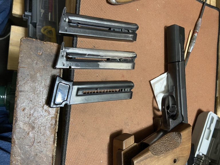

Thanks for all the help and great info. I decided to try and make a mag from a S&W Model 41 mag. it fits and holds the slide back when empty. Just need to try it at the range with live ammo. At the top is a S&W Model 41 Mag. Att the bottom is a Factory Hämmerli mag and in the middle is  the altered mag.

The mag performed flawlessly with about 100 rounds in both slow and sustained fire. No FTF or FTE and the slide stays open after the last shot. Think I'll make another since 3 is the sweet spot for me with mags. 2 mags for the stage and one in reserve for an alibi. It only took about 1/2 hours worth of work with a Dremel. I removed the tight spots on the body with a Dremel mounted sanding cylinder and the slot was cut with a Dremel diamond cut off wheel. Relief for the slot was done with a small cylindrical diamond grinding stone. In case anyone wants to try, these are the instructions I followed.
S&W Model 41 magazine conversion to Hammerli 208/215
1) Disassemble the magazine.
2) Remove the grips and magazine catch from the Hammerli.
3) Slide the magazine into the well and note where it starts to bind.
4) File or lightly grind the sides to relieve the binding.
5) Be sure to clean the magazine thoroughly before each check so you
don't transfer filings into the gun.
6) After you have a smooth working magazine, compare it to your old
Hammerli magazine (you may have to disassemble that one too) and mark
the back to match the length of the original with the top of the two
magazines even.
7) Cut the slot such that the top edge will match the bottom of the
Hammerli magazine tube. You might also want to relieve the sides
slightly so the bottom edge rests on the catch, instead of the two side
cuts.
8 ) Clean everything well to keep any filings out of the gun.
9) Reinstall the catch and reassemble the magazine.
10) Test the magazine for fit and see if it locks the slide back.
11) If it doesn't lock the slide back, remove and disassemble it again
and cut the two side slots just a little higher. Check closely how far
up the slide stop is lifted. Make sure it is more than just barely
catching in the slide.
12) Clean everything well, reassemble and try again.
PaulK51
