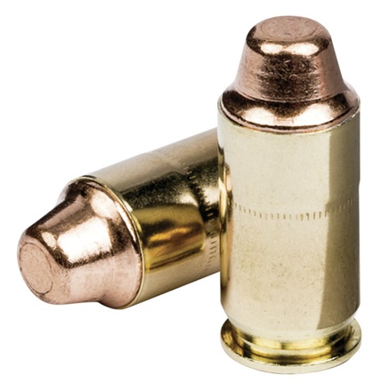

Froneck wrote:I see everyone talking about HardBall but I thought the CMP changed the rules and wad cutter is now legal???
You must shoot a Jacketed round either FMJ, JHP, or a FMJ - semiwadcutter like the one shown below.
1911 must have slab side grips, iron sights, and a 4 trigger weight. rules are here page 33: http://thecmp.org/wp-content/uploads/Rulebook.pdf
Federal Gold Medal 185gr
Last edited by dronning on Sun Mar 24, 2019 3:53 pm; edited 3 times in total (Reason for editing : lost link to pic)
