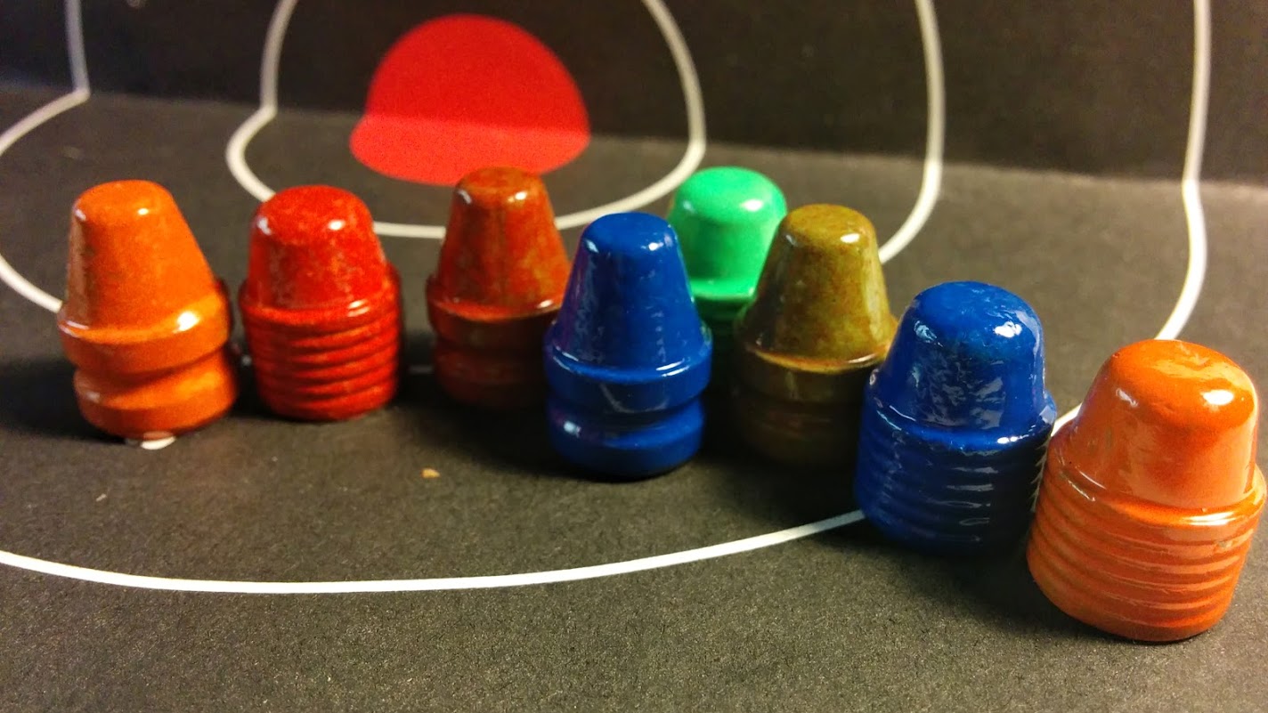

for the Lee seater
i just measured the inner dia of the shoulder of the 2 kinds of swc i use (both lee)
and drilled it to the size needed
now i dont ever have to change the depth setting even when switching bullets
and since the lee bullets are so close in seating depth  there isnt anything different
i also load the lee 145gr swc for 40  and did the same thing
they just seat better

Post by guncheese 8/13/2015, 4:35 pm
dont bother with the powder coat guns
all of mine (yes the ones in the pic) were done by twirling them around in a cool whip container
plenty of info on the shake and bake method on the web
easy,super cheap,clean and the bottom of the bullet gets coated as well (lots of indoor rages that dont like lead  allow powder coat)
