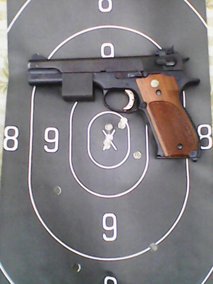

Post by SW-52 8/15/2016, 1:26 pm
smith wesson 52's are espectacular pistols,very scarce and super accurate. the bad of this pistol is the non availability of aftermarket Match barrel and mags are super scarce and high prices. i work my barrel with lewis lead remover,kano kroil and JB Bore compound(once a year). the 52's are very special,i love my 52-2!       Advice on purchasing a S&W Model 52 - Page 5 My_52-10
