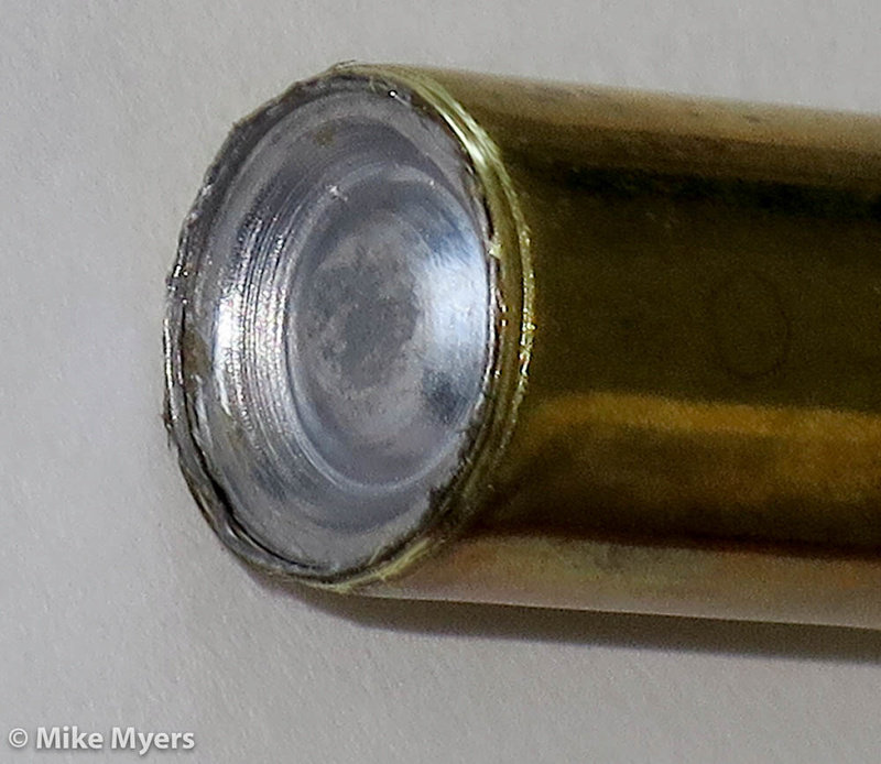

Before I gave up on the idea, I thought my goal was to push the bullet in slightly below the end of the brass case, and then use the roll crimp to "bend over" the end of the brass case. After about an hour, I gave up on that idea, at least for doing the seating and crimping in the same station.
My guess is that what the following photo shows, is the result of crimping the bullet too early in the process, so instead of bending the end of the case over the bullet, it starts scraping off lead as the bullet is being pushed in. I think I was also trying for too much crimp - just learning what to do, with all the time in the world to figure things out.
What I thought I was trying to accomplish was this text:
"I use a rather heavy roll crimp to give the case mouth a nice rounded shoulder to aid in feeding."

That's what I was trying to do, before I gave up, and instead tried to just match the Winchester factory rounds.
I was going to delete all my old photos, but decided I should post one here anyway.
(I'm a photographer - I take photos of everything, including things that didn't work as expected. )
