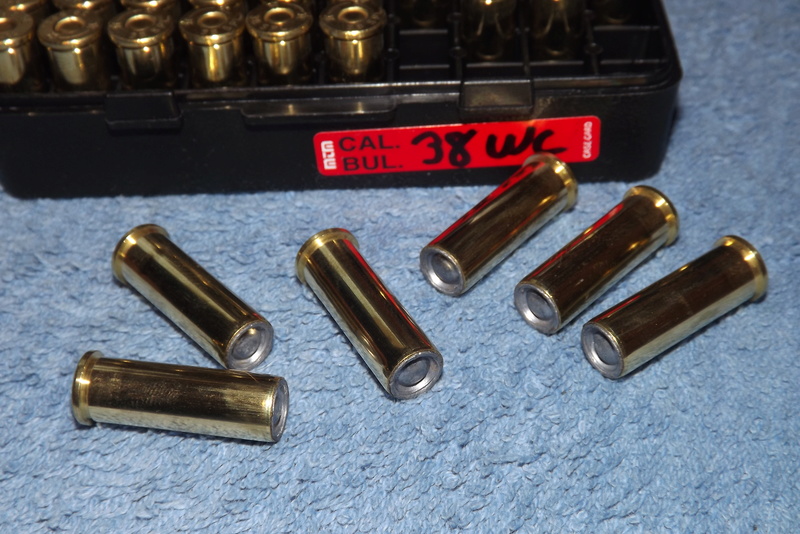

I load for my 52-2 on a Dillon 550. Starline brass, Zero 148gr HBWC, winchester primers, 2.7 gr WST 1.155 oal taper crimp. I had feed issues using 1.16 oal which is a number I've seen used a lot. at 1.155 it runs flawlessly.

If you look at bullet sites like Precision Delta, they often have close up pictures of loaded ammo.

nice rounds. what brand of bullets,zero or other brand?? crimp,roll or taper for 52 pistol?OldMaster66 wrote:I also have an extra die to do the roll crimp separately. I forgot to mention I use a swaged bullet also. I had to make a seating die by modifying a smaller caliber round nose insert into my 38 special die. I made it flat and capable of fitting inside case mouth without touching case. Someone can probably tell you where to find that part from Dillon but I have a lot of extra parts here to play with. This is what my loads look like finished.

To answer SW-52's questions. I use a Magnus #514 swaged 148gr HBWC. http://saas.shopsite.com/magnusbullets/store/page11.html These are new Starline cases that the bullet is seated with a tiny bit of lead past the case. C.O.L. is 1.163. This length works great in all 5 of my magazines. I use a rather heavy roll crimp to give the case mouth a nice rounded shoulder to aid in feeding. The "tiny" bit of lead past the case is to insure that the roll crimp is touching the bullet and not just crimping air. I load this case with 2.8 gr of Bullseye powder.

They look just like factory Remingtons, except the bullet of course.
