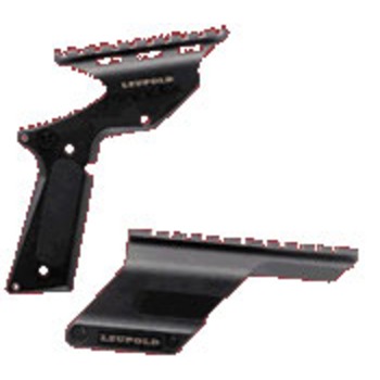

Post by LenV 5/22/2017, 3:09 pm
It looks like the Leupold mount for a model 52 could be modified to work. Strongest mount would require some drilling and tapping but only under the existing grips. Put grips back on and zero holes would show. Just how I would do it. Or not. I did drill and tap the slide on my 952-2 6". They are going for around 5,500.00 now.
http://www.gunbroker.com/item/647273551
Posts : 4799
SIG P210 scope mount for red dot Empty Re: SIG P210 scope mount for red dot
Post by cl_fletcher 5/22/2017, 11:03 pm
There does not seem to be any difference in price for a excellent condition Swiss made P210 and a shooter grade Swiss P210.  It seems all Swiss P210 are expensive and the prices are the same.
Having a custom made grip mount type one made would work great I think.  But who can make one and being it's just one made I think it would be expensive.
cl_fletcher
Posts : 10
Join date : 2014-11-24
Post by LenV 5/23/2017, 12:15 am
cl, I was not suggesting you have someone build one from scratch. If you take a quality mount like a Leupold any good machinist should be able to modify it to fit. I picked the one that fits the 52 because the profile is a pretty good match to a 210.

Post by LenV 5/23/2017, 9:43 am
Leupold 52143. Ignore the picture. Ignore the picture. Ignore the picture. Did I mention that the picture is wrong?But that is the correct number.
https://www.amazon.com/Leupold-52143-Quick-Install-Wesson/dp/B005D2HBPM/ref=sr_1_1?ie=UTF8&qid=1495549999&sr=8-1&keywords=leupold+52143
Posts : 4799
Post by Magload 5/23/2017, 10:56 am
Yeppers Ignore the picture as I ordered one a couple weeks ago.  I think it sets the optic to high above the bore but if I watch the level on the optic it doesn't matter.   I also think it is butt ugly but feels good.  Don

Post by cl_fletcher 5/30/2017, 4:28 pm
I compared a Smith & Wesson Model 52 grip to my SIG P210 grip to see if the Leupold frame scope mount can be modified to fit the P210.  It cannot, mostly because the 52 has a steel back-strap that is part of the pistol's frame whereas the P210's frame does not have a steel back-strap; the P210's back-strap is part of the wood grips.
So the Leupold frame scope mount can not be modified to fit the P210.
