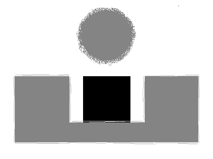

Perfect GAP size.
This came from AP world and a study done on sight GAP size. Seems that the perfect GAP size is to have the same width on both sides to be the same as the front sight blade, as it appears when aiming at the target of course. This all goes back to your subconscious wanting to see things that make sense and the 1/3, 1/3, 1/3 picture makes your subconscious happy. Next best is 1/2 the width of the blade. That would be 1/4, 1/2, 1/4.
They also said that if you use a sub 6 hold the gap below the target should match the gap on the side of your sight, again it makes your subconscious happy. Of course as with anything your results may vary.
Hope this makes sense.
I opened up the rear notch on my 22 and it made a big difference.

Hmm, interesting thought - Perfect Gap Size. I'll try to measure the Les Baer, and see what the dimensions are, while viewing the gun with my eye 24" from the front sight.
mikemyers- Posts : 4236
Age : 80
Re: Iron sights blend into a black bullseye
OK, width of front sight: 0.133
Spacing of opening in rear sight: 0.11
I held out the gun at something close to the distance I shoot at, while holding a camera in front of my right eye, guessing where to put things to get both the front and rear sight in the picture. It's hard to do. This is close to what I see when I hold the gun in front of me. Looking back and forth between the gun held out at shooting distance, and this photo, I can't see a difference. (Photo has been lightened to show the serrations on the rear sight.)
It's close to 1/4, 1/2, 1/4
...and just to repeat, my problem isn't seeing the gaps well enough to keep them equal, it's seeing the gaps at all. When everything is black, I was struggling to keep them equal only because of the color black. Shooting at a white target is no problem.

To get 1:2:1 with the 45, I think that you need a wider notch. Mine is wider than the front sight. I will remeasure tonight. I did the same thing to my High Standard.

I prefer a wider rear notch, I hold center mostly(pending on the range lighting) but I don't want a thin front sight. I also like a deep sight notchjmdavis wrote:To get 1:2:1 with the 45, I think that you need a wider notch. Mine is wider than the front sight. I will remeasure tonight. I did the same thing to my High Standard.

MikeMyers,
In one of the comments above you said that there is no problem for you seeing the sights when aiming in the white.
My advice is for you to do just that.
Switch your aiming point to be a point halfway between the bottom of the black and the bottom of the target. Just dial enough up clicks on your sight to make the rounds hit the middle of the black. This is called "sub-six" hold and is very effective.
Dryfire the same way.
Oh, and making sure your vision isn't anywhere other than the front sight is very important. You can perceive that you have everything aligned perfectly, but if your vision was at the rear sight, or the target, or anywhere other than the front sight--even though you thought everything was lined up when the shot broke--the shot will be more askew than if you were on the front sight and your alignment was a little off. Your brain will still try to keep everything aligned as best you can even if you aren't looking to see where the rear sight is.
