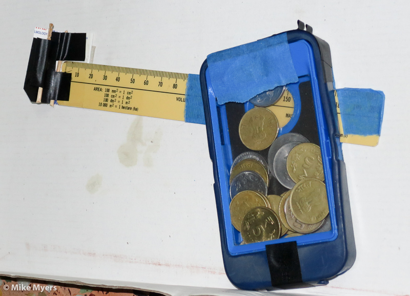

My own advice is to get an exact prescription for your eyes, to the front sight. I made the gizmo shown below, that puts a business card at the same distance as the front sight, so I could see the small lettering. That seemed to satisfy the people doing the refraction. If your refraction is done for that exact distance, that is the sharpest your front sight will look. (If you do this for one hand shooting, it won't work that well for two handed, and vice versa.) As for my gizmo, I added "sights", so now that I've got my glasses, I can use it for "holding drills" while I'm away from home. The phone case is now fully filled up with Rupees, to approach the weight of my 1911.

The following is for my new shooting glasses:
Distance prescription for "infinity", red dot sight: +0.5 diopters
Prescription for one hand shooting, 30" to front sight +1.5 diopters
Prescription for two hand shooting 24" to front sight +1.75 diopters
If my arms were shorter/longer, or my gun had a longer distance to front sight, these numbers might change.
