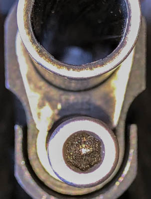

The Salyer wad gun I am now using was fitted with an extended guide rod at the request of the original buyer.  I've never taken a gun like this down for cleaning.
Is the procedure to first use an Allen wrench to remove the guide rod extension, and then take the gun apart as with any normal 1911?  Anything else special I should know about ahead of time?
The gun has a Kart barrel and bushing; hopefully the bushing isn't as tight as what Les Baer does.
Disassembly of 1911 with extended guide rod Img_5910
