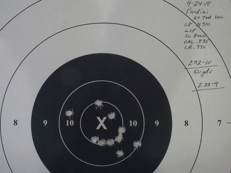

Preliminary test results for the 85XTP in a factory Pardini 32 ACP barrel at 50 yards.
Very little load data to be found. Only Accurate listed any loads with the 85 grain XTP bullet.
Not sure what the 32AXP is.
Do Not Load This For Your Pardini!!! The overall length to too long. I shortened my next test batch and I expect higher pressures/velocities.
More testing this Sunday.
Edit below for clarification....
Forgot to mention that the barrel is mounted in a test fixture.
No, I do not, nor ever have, owned a Pardini 32ACP. I just happen to have a couple of factory barrels, a barrel tester, and, apparently, too much time on my hands.

32acp Group Photos
Dave asked if I had any photos, so here are several I kept. The first shows a group with 2.3gr Titegroup and the 60gr XTP. First shot was near the paper edge so I adjusted the Ransom Rest and shot a group of 9. The other photo of this load is a 10 shot group. The third photo is with the .314 T&B 60gr SWC and 1.8gr N310.
I used a Ransom Rest and Andrew Berryhill's grip insert for the Pardini. It is a 3D printed plastic block that screws to the Pardini like a grip would and mounts on the Ransom Rest as a normal insert would. It seems to work pretty well.
I should note that I have not yet chronographed these loads, but I did try a range of loads with these powders and with Bullseye. The results showed the accuracy to decline pretty rapidly with a change in powder weight of only a couple of tenths.
Greg, I tried 1.6gr of N310 with the T&B bullet and the groups opened up to 5-6", which discouraged me from going down any further.
Last edited by Dr.Don on 5/13/2018, 4:01 pm; edited 1 time in total (Reason for editing : Added comment.)

Greetings Dr. Don,
Many thanks for the images.
Your efforts are paralleling mine.
The faster the bullet travels the smaller the group.
My concern is that the faster velocity may be a bit much for the pistol causing accelerated wear.
How does the recoil of the hand loads compare to the Hornady 60XTP commercial ammo?
Your results with the cast bullets are very good, especially fired from a Random Rest!!!
My testing today was so dismal, I was ready to pack in the 32ACP program. I will load some more based on your data to see if I can repeat the results.

Dave,
The 2.3gr Titegroup loads do not feel as harsh as the factory Hornadys to my hand. The Hornady factory load chronographed about 940 out of my 4.5" Pardini. An earlier load I tried using 2.1gr Bullseye chronographed 915fps. So I expect the 2.3gr Titegroup load to run about 950-970fps, but that is all speculation until I get it tested.
Here is an interesting data point for your "faster is tighter" theory. I bought a box of Fiochi factory loads using the 60XTP. They were seated too long for the Pardini mags, so I re-seated them to .895. I know that is risky and would not recommend it to others, but I saw no pressure signs so I shot a group with it. This was before I got my Ransom insert for the Pardini, so it was over sandbags. It chronographed 1177fps and shot about a half inch tighter than the factory Hornady I tested the same day.
Those of us who fool with barrels are probably thinking a 10 or 12 twist barrel for the Pardini would be pretty neat, but the shroud makes it really difficult.
