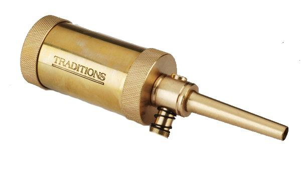

Question... I've asked this before, but now I understand things better.
This is where I keep my powder:
https://www.traditionsfirearms.com/product/field-flask-a1292
Is one of these, partially filled with black powder, small enough that I can keep it stored in my condo, without having any worries about it? I already have my smokeless powder (Unique and Bullseye) and a bottle of Pyrodex (in case I can't get anything else). My only experience with black powder has been the past month or so with the Ruger. If I leave home for a couple of months, is this something I should find another place for while I'm gone?

For anyone else reading this thread, while this little composite powder measure will make you look more like a chemist than a machinist, it is SO fast and accurate, and precise and easy to use!!!! You know for sure exactly how much powder came out of your powder flask. Powder and filler pours right out of the tube into the chamber, no spills, and you can SEE it happening.
https://www.traditionsfirearms.com/product/composite-powder-measure-a1381

This is what I used for a while when I started and I know many who still use it. Traditions are not the only ones that make it either. Pretty much he golden standard for powder measures.
https://www.muzzle-loaders.com/traditions-brass-powder-measure-120-grains.html
Your flask is a field flask. Holds barely enough for one outing in my opinion. Ought to be legal.
I use a powder drop with a spring loaded gate and an adjustable powder measure that fits flush with the drop. The drop needs to be mounted to something but I get exactly what I want and its repeatable.

Yep, the Traditions field flask holds 2.5 ounces, rounded off to 1000 grains.
Divide by 20 grains, the load I'm using, and it's good for 50 shots.
By the time I leave on my trip, it may well be empty.
You wrote:
"I use a powder drop with a spring loaded gate and an adjustable powder measure that fits flush with the drop. The drop needs to be mounted to something but I get exactly what I want and its repeatable."
Maybe sometime you can take a photo of this. I don't know enough to be able to visualize what you're doing. Is this something you made, or that people can buy?
If they allowed it at my club (maybe they will, for when I'm just practicing) I would use the loader I bought, fill five chambers with powder, then filler, then ball, ram it together, add grease, place in gun, and add caps. Then I could take 5 shots in a row. I don't mind doing one at a time as I am now, as I'm getting used to everything, (I assume caps don't get added until the cylinder is in the gun, right??)
