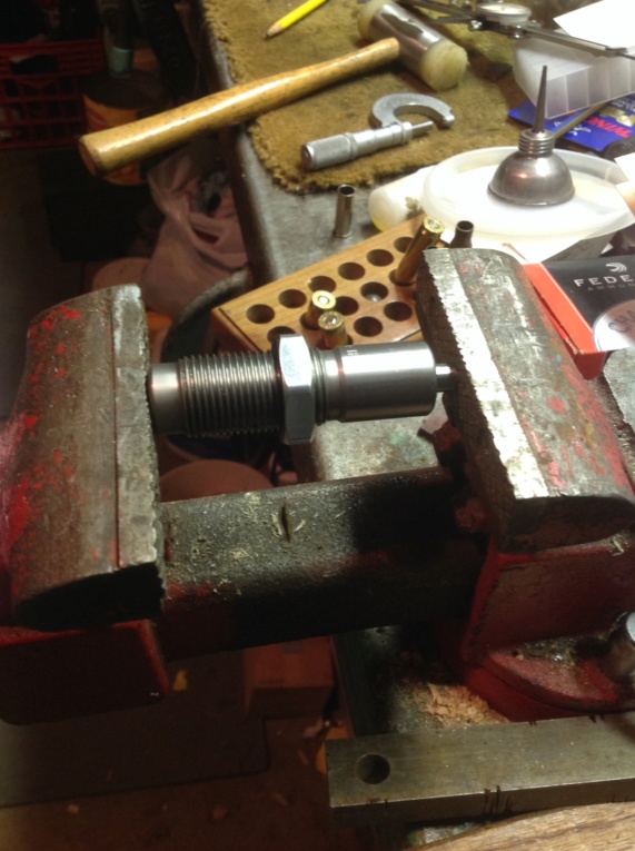

Poor mans versions using a Lee sizer and two mandrels in a vise. Snug it up until it stops yielding, no need to squeeze it to death. Rap base plug to eject bullet and nose plug. Slide bullet base on a steel surface to clean it up a tad. I have one extra Lee 314 die, will have a plug set shortly. 50 yard target hand held is better than l got with other reloads.S&W 32Long Copying the H&N .314 HBWC for Reloading Img_0314
S&W 32Long Copying the H&N .314 HBWC for Reloading Img_0313S&W 32Long Copying the H&N .314 HBWC for Reloading Img_0314
S&W 32Long Copying the H&N .314 HBWC for Reloading Img_0313S&W 32Long Copying the H&N .314 HBWC for Reloading Img_0315
S&W 32Long Copying the H&N .314 HBWC for Reloading Img_0316S&W 32Long Copying the H&N .314 HBWC for Reloading Img_0315

Post by fc60 on 8/24/2018, 11:53 am
Greetings Bruce,
What pistol did you use?
How about brass and powder?

Post by bruce martindale on 8/24/2018, 6:38 pm
A Walther with a 314 barrel. Remington brass, 1.9 231.
On this first run, l didn't resize the brass. The H&N are 314 as well and l didn't get the best results with those either hence l removed any possible inside diameter issues.  I am getting a tad larger than 314 here since there is some taper to the Lee die and I am not pushing all the way through. They exceeded my expectations on the limited trial. Npw to test some more. The Speer "314" were as low as .312. Sorry about the extra pics, not sure what happened there.

Post by fc60 on 8/25/2018, 11:58 am
The Speer bullets are harder than most other brands.
My swage dies are honed to 0.314" +/-0.0001".
The "bumped" Speer Plinkers come out of the die at 0.3143". There is some spring back to the metal.
Yes, the Lee dies are tapered but if you bought one, say 0.311", have a machinist hone the die to 0.314" cylindrical.
I suspect the Lee dies are carbo-nitrided so try to remove as little material as possible.
With the bumped bullets, I find that either R-P or Lapua brass sized to an outside diameter of 0.334" produces a nice fit with the bullet. I do not use an expander plug. I only flare the case mouth.
Powders that have worked well for me are...
1.70 grains of VV N320 (three-twenty)
1.40 grains of VV N310 (three-ten)
1.70 grains of Alliant Bullseye
1.65 grains of Winchester WST
1.27 grains of Hodgdon TiteWAD ( NOT TiteGROUP)
1.70 grains of IMR PB
Use any small pistol primer EXCEPT Winchester Magnum. (WSPM). These increase the velocity.
All are within 680-730 FPS
Important!!! Keep the barrel throat clean. Any Lead fouling ruins the grouping.
