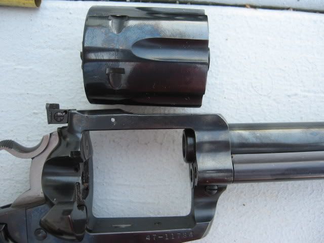

Oh, I have guns (and Cars) that I take apart and play with.  They have been known to stay in pieces for years.   Match guns and daily transportation guns are off limits... Smile
